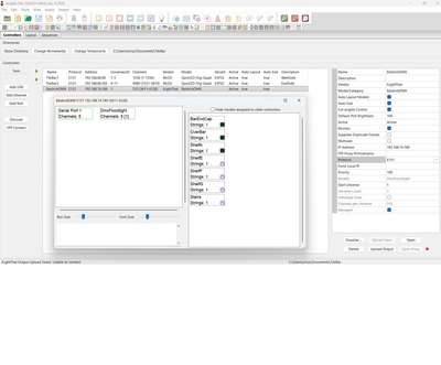

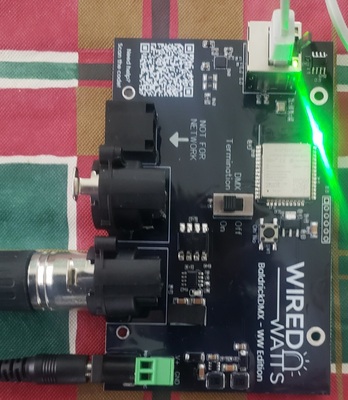

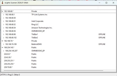

hanks for following up. Attached is a picture of the board powered up and connected to the network. It is connected to a TP-link TL5G105E. Screen shot of the Controllers tab with the error message in lower left Screen shot of XScanner. When I type http://Baldrickboard.local, I get a time out and “this site can’t be reached” This is normally set-up at home where it is also connected to (2) QuinLED Quads, but I brought the TP Link switch and the BaldrickDMX board with me to work for troubleshooting. Attached images: BaldrickDMX_xScanner.jpg, BaldrickDMX_xLights.jpg, DMX_Board.jpg
May 7, 2026 at 02:57 PM
Hi Eric, can you send me a photo of the board switched on, and what xScanner says.. Might also be worth giving http://baldrickboard.local a check.
When I initially got the board, I pressed the button to wake it - nothing happened. I typed http://baldrickdmx local into my Chrome browser, no response "this site can't be reached" I typed the address 192.168.74.189 and got "Can't be reached took too long". I tried resetting to factory by pressing the button for 5 seconds while applying power. Nothing changed on the board's lights to indicate a reboot. Nothing changed on the board status or ability to connect. With power on, the Power LED is lit (green) and there are is a blinking left LED and solid right LED on the network connection.
