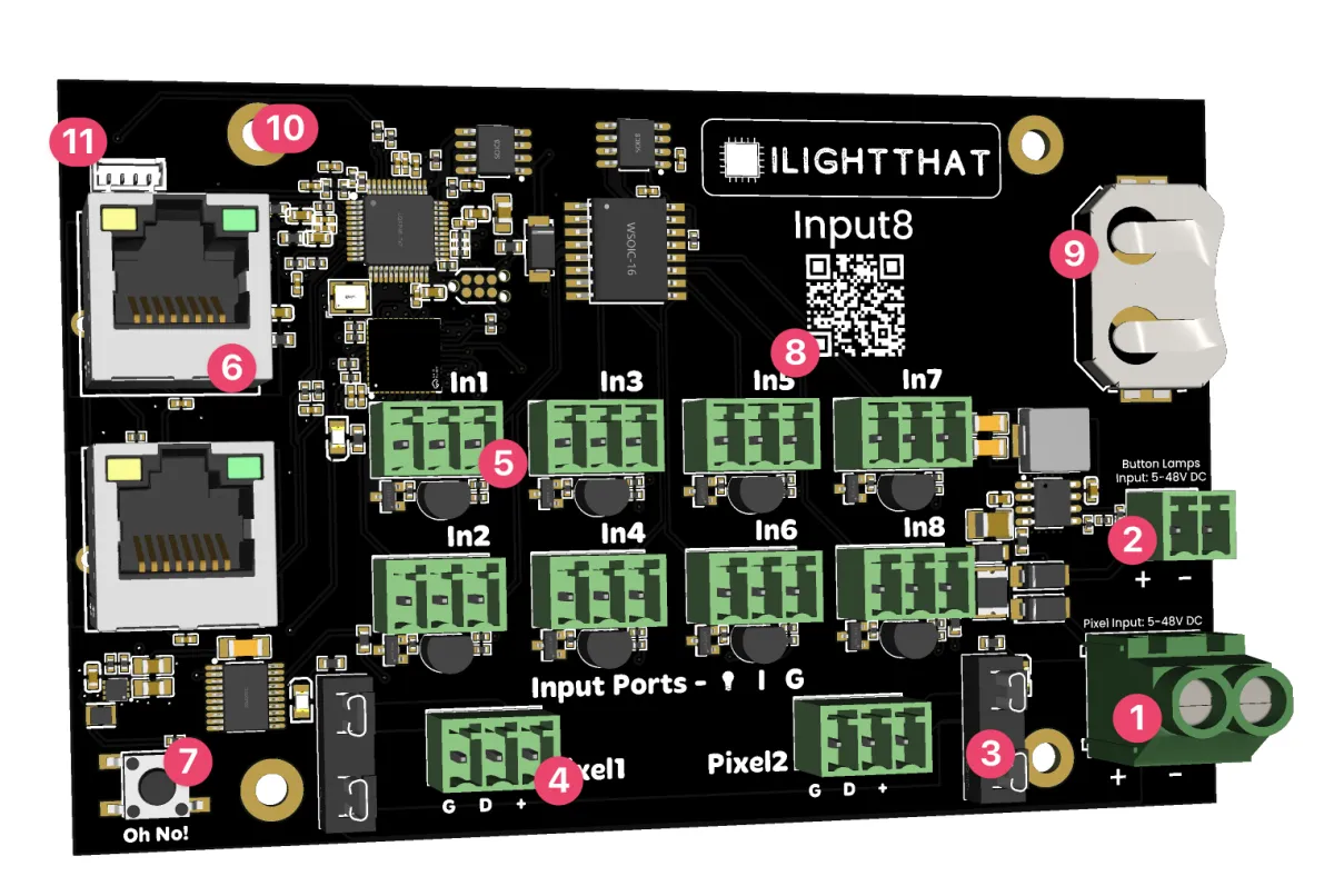

BaldrickInput8 Board Overview
  1. Pixel Power Jack — Can take 5v to 48v and will automatically step down to power the board.
  2. Lamp Power — Working on the basis that you might want 12v pixels but 5v lamps in your buttons, we’ve added a separate power for your lamps (if you don’t use lightup buttons you can ignore this).
  3. 7.5amp fuse — Nothing much to say here.
  4. Pixel output — Can output up to 750 RGB pixels at 40FPS.
  5. Turniputs — Our advanced input powered by the Turnip Network.
  6. Dual 100mb Ethernet Port — You can use this to connect to your show network then daisy chain something else (like a Baldrick17 or a BaldrickSwitchy).
  7. Oh No button — Use this to reset the board by holding for 10 seconds when the board is booting.
  8. QR Code — An easy to scan QR code which will take you to these docs for easy troubleshooting.
  9. RTC battery — Keeps the time even if not connected to the internet, perfect for scheduling effects to go on and off at certain times.
  10. Mounting Holes — The BaldrickInput8 is classed as a medium family member.
DO NOT DRILL out these holes to make them fit the screws you’ve got already, doing this will void any warranty.
