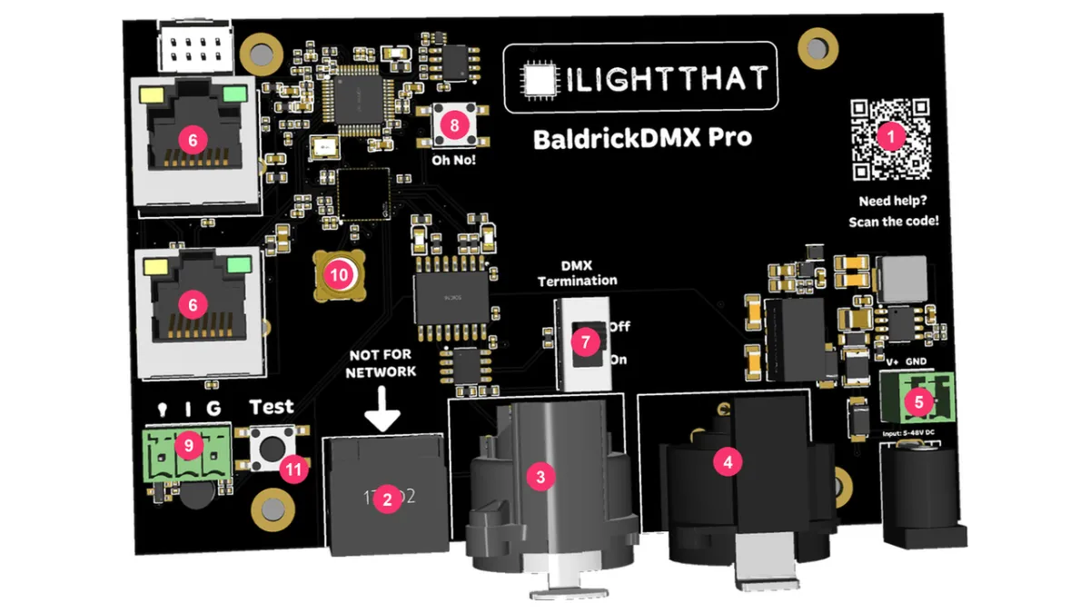

BaldrickDMX Pro board overview with numbered parts
  1. QR Code — An easy to scan QR code which will take you to these docs for easy troubleshooting.
  2. DMX OUTPUT RJ45 — With a helpful reminder NOT TO PLUG THIS PORT ON YOUR NETWORK.
  3. DMX OUTPUT 3 PIN — A fancy schmancy Neutrik XLR.
  4. DMX OUTPUT 5 PIN — A fancy schmancy Neutrik XLR.
  5. Power input — You’ve got the choice of a Phoenix connector or barrel jack (DO NOT USE BOTH), these can take 5v to 48v and will automatically step down to power the components, no jumpers needed.
  6. Ethernet ports — Two 100Mb ports joined by a built-in switch. Plug one into your show network and use the other to daisy-chain to your next board.
  7. DMX Termination switch — DMX cables need to have their ends properly terminated to prevent any issues with the signal. Sometimes, the cable plugs have this built-in, but if they don’t, this switch lets you do it right there.
  8. Oh No! button — For factory reset, in case you break the board and need to reset it to factory settings. When held for 10 seconds during the board boot process, the controller will reset to factory settings, everything will be removed including the latest firmware and it will be in the ‘shipping state’ where you click to update to the latest firmware.
  9. Turniput port — Connect a button, motion sensor, reed switch, beam break or other input device and use it with The Turnip Network.
  10. WiFi antenna connector — Screw on an external WiFi antenna for Busk Board, CunningFX and board control over WiFi.
  11. Test button — Pressing it acts as if the device on the Turniput port had been triggered, so you can test your actions without wiring anything up.
The BaldrickDMX Pro has the same medium footprint as the Baldrick8, so you can reuse your Baldrick8 bases and mounts. DO NOT DRILL out these holes to make them fit the screws you’ve got already, doing this will void any warranty.

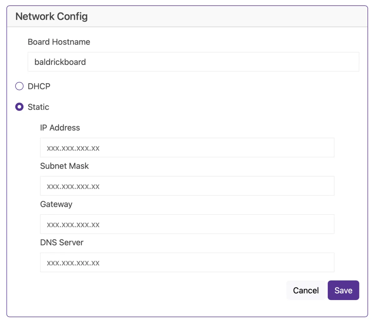

BaldrickDMX Web Interface Networking
The default hostname is baldrickboard (hence baldrickboard.local). If you have one BaldrickDMX Pro then it’s completely fine to keep this as it is, however if like us you want to collect a few of them, then we’d recommend you change this to something like frontgarden or upstairsroof

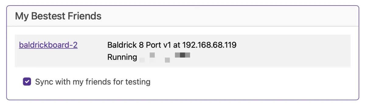

BaldrickDMX Web Interface Friends
The BaldrickDMX Pro will keep an eye out on the network for other Baldricks and let you know how they are doing (this is helpful as we don’t put an LCD screen on the board).
Test Sync
Ticking this box will sync the test mode between all compatible boards, meaning if you are doing something on the house and want all your baldricks in Test Mode, it’s very easy to do!

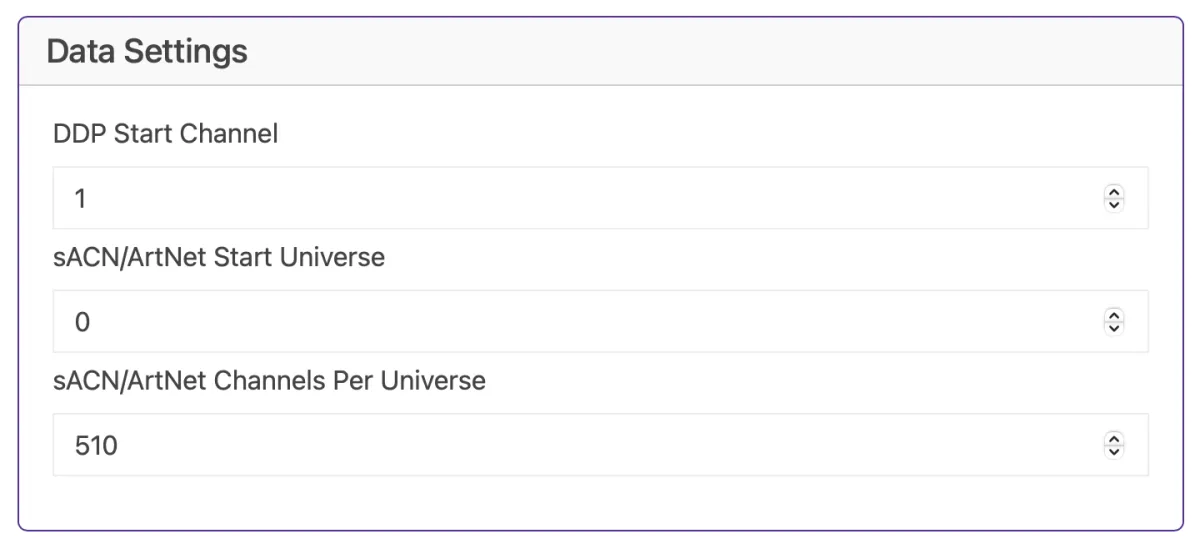

BaldrickDMX Web Interface Data Settings
