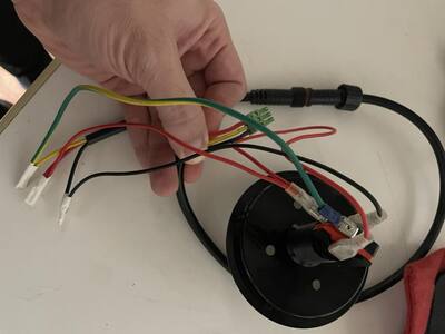

Hello, this year i run 3 baldrick 17 boards. In one of them i tried to use one of the turinputs to light up a button and when pressed launch an fpp sequence. I followed the video of greg: https://www.youtube.com/watch?v=DIhsneRz0JA that is refered to baldrick input but was supposed to be the same for the turnips of the baldrick17, however when i pressed the button the board died, a smoke came up near to the ethernet ports. Obviously i didn't tried in the other baldricks. My big concern is what i have done bad, to prevent from fry another board next year as i would like that button attached to that baldrick. Any ideas of what happened or what can i do?

I don't know how to upload more images, i don't see any button in the website to upload now more images, so the only image i uploaded when i created the case is the one i can see.

Hi Miguel, Could you share a picture of how you have this connected up (I know you say as per the video, but can we take a look at it anyway?) and also send a close up pic of the area that smoked? Thanks!
I already sent an image of how was wired, i don't see any option in this page to reply i can just edit my first step, and i don't see how to add more images :S
