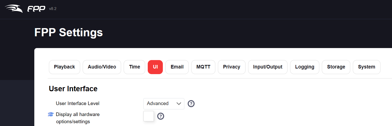

First up, we need to ensure your UI is set to advanced.
FPP Advanced mode

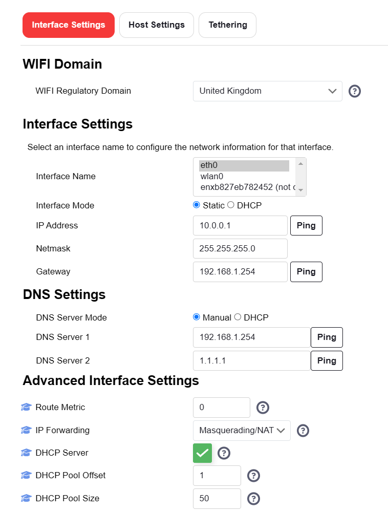

Then under Network Configuration (eth0) give it a static IP outside your regular range and setting the Gateway and DNS as your regular WiFi router. I set IP Forwarding to Masquerading/NAT and enabled DHCP server:
FPP Network Configuration

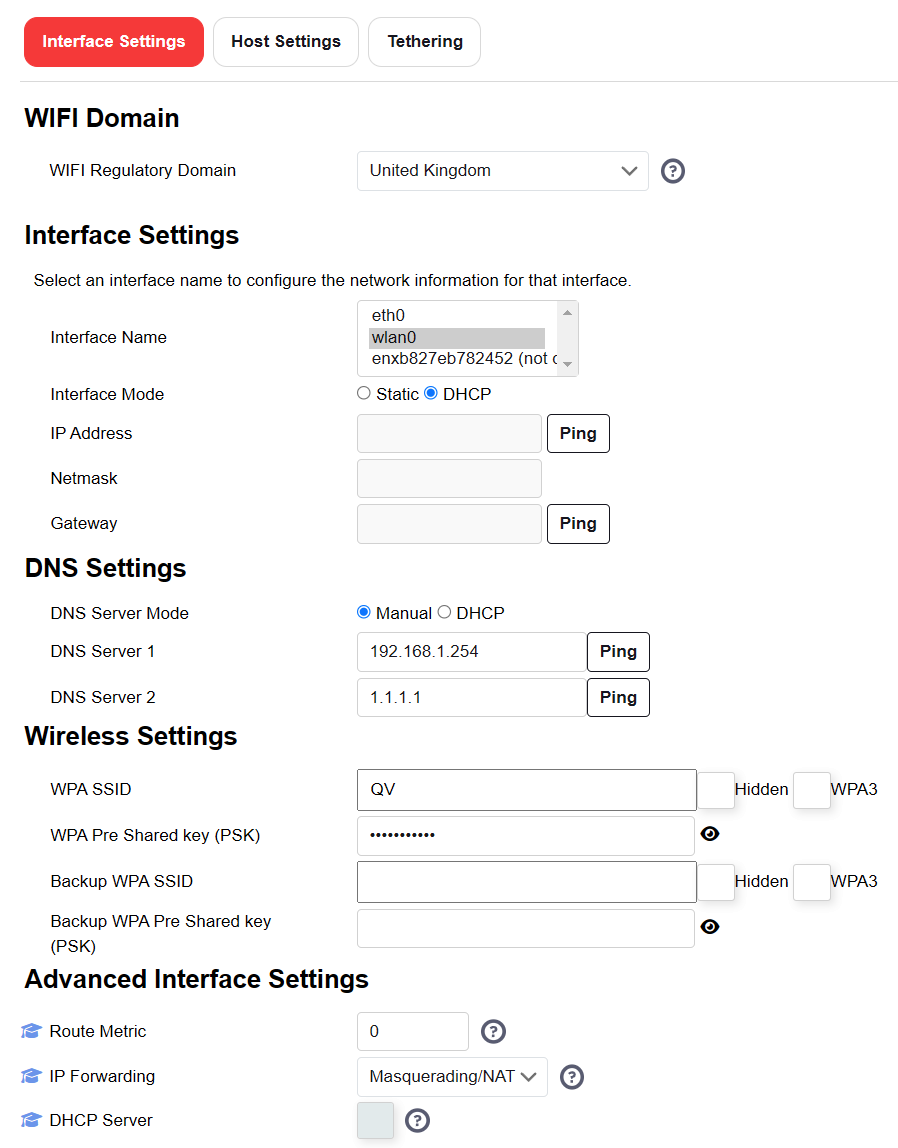

And then on Network Settings (wlan0) I left it on DHCP, but ensured the DNS remained on manual with the settings as above. I set IP Forwarding as Masquerading/NAT once again.
FPP WLAN Settings

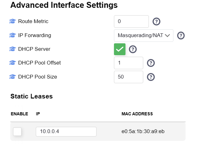

Once completed, I save & reboot the Pi. Having rebooted (mine didn't come back the first time and I had to power cycle it). I then plugged Baldrick into it & powered it on.
A few moments later, I checked the Network Settings / Eth0 and It has seen the Baldrick and assigned an IP address to it. I could then check the Enable box to set a DHCP reservation (so it doesn't move IP's).
FPP DHCP Reservation

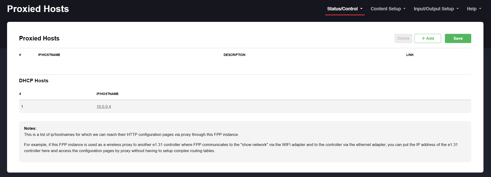

With that active, I could then go to Status/Control, Proxy Settings and under DHCP hosts was an entry for the Baldrick:
FPP Proxy Settings

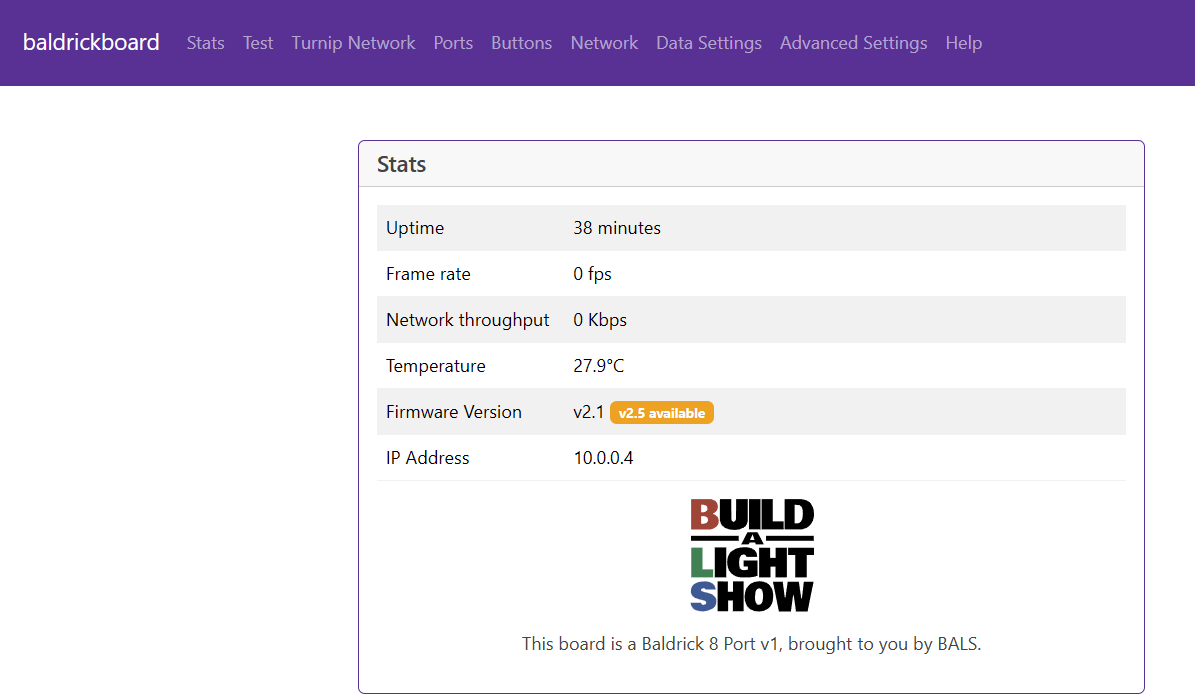

Click that link and up comes the Baldrick webpage.
Baldrick Web Interface
That is telling me that v2.5 is available, so that shows it has internet connectivity.
Job done. Now you can set it up in xLights, with the IP listed above (10.0.0.4 in my case) and the proxy being the Pi's Wifi IP (in my case 192.168.1.57)

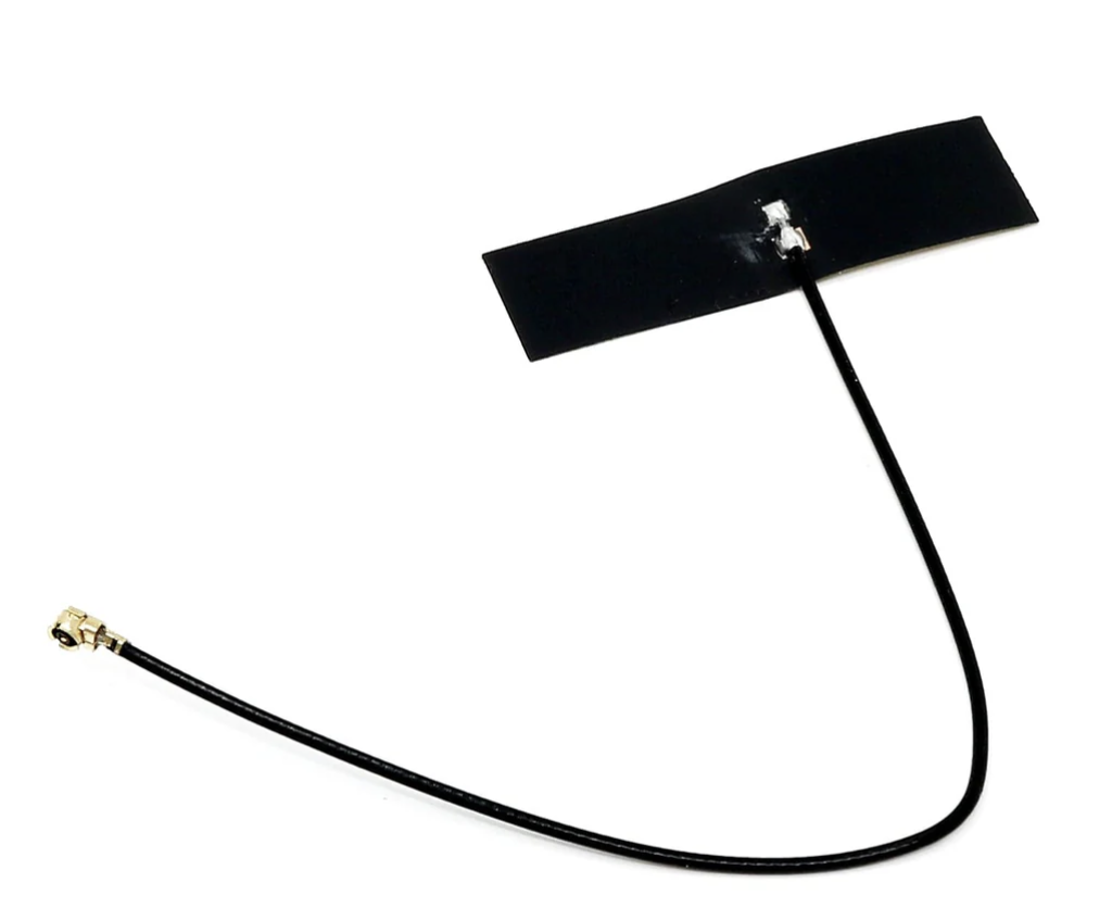

Some of our boards (BaldrickInput1 & BaldrickSignals) require an antenna to work.
Typically we supply a 3dBI antenna which (depending on surrounding environment) will have a range of up to 10-15m.
Your vendor may stock larger antenna or you could use amazon / Aliexpress.
The connection on our wireless chip has many names uFL/u.FL/IPX/IPEX-1, these will all fit.
