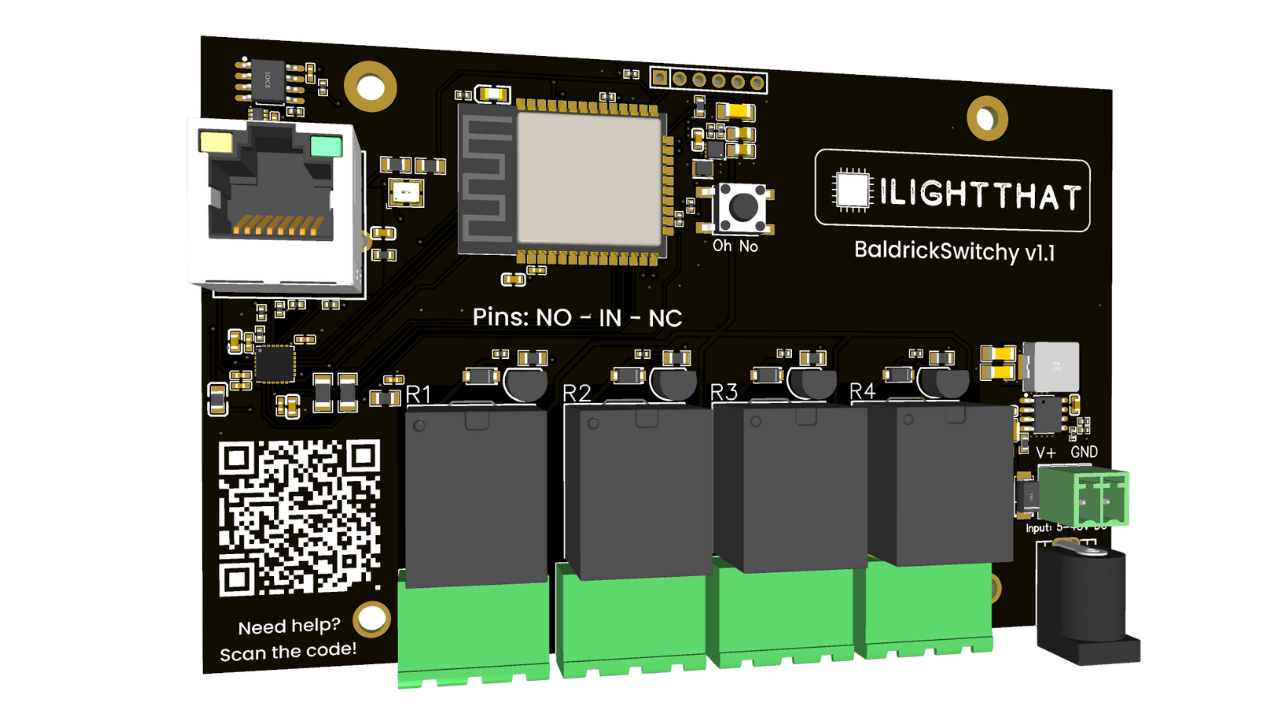

The BaldrickSwitchy is a high-power relay controller designed for AC device control and traditional lighting. With precise timing control and safety features, it's perfect for controlling motors, lights, and other high-voltage applications.

Relays4 channels, up to 8A and 300V (AC/DC)
ProtocolsDDP, Art-Net, E1.31, sACN
Power input5–48V DC with onboard power management
IntegrationxLights push, Turnip Network
MountingSmart-receiver compatible footprint
