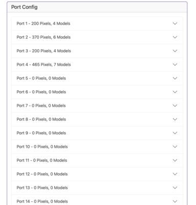

My lights seem to be doing different things when FPP is playing?

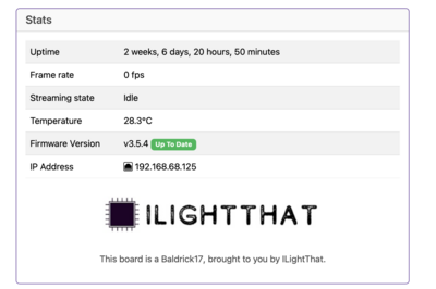

{"ram_available":52020,"ram_minimum":16,"ram_largest_block":23552,"uptime":1803075,"oom_count":2278,"host_comms":{"comms_state":[32]},"board_manufacturer":"ILightThat","board_model":"Baldrick17","flags":5,"temperature":[28.25],"network":{"ethernet_available":true,"wifi_available":false,"ethernet":{"ip_address":"192.168.68.125","subnet_mask":"255.255.255.0","gateway":"192.168.68.1","dns":"46.33.128.50","connected":true}},"network_throughput":751,"fpp":[{"hostname":"MAINBIGSCREEN","sw_version":"7.5","ip":"192.168.68.163","hardware":"Raspberry Pi 4 Model B Rev 1.5"},{"hostname":"FRONT-AUDIO","sw_version":"7.5","ip":"192.168.68.164","hardware":"Raspberry Pi 4 Model B Rev 1.5"}],"last_settings_update":1437834009,"ota":{"updatable":[{"current_firmware_version":"v3.5.4","current_factory_version":"v5.2.7","current_bootloader_checksum":"32ab0d624bb399dfd976b2158905546e","current_partition_checksum":"9c57a76ed996748ee7393a41df755985","available_firmware_version":"v3.5.4","available_factory_version":"v5.2.7","available_bootloader_checksum":"32ab0d624bb399dfd976b2158905546e","available_partition_checksum":"9c57a76ed996748ee7393a41df755985"},{"current_firmware_version":"v3.5.0","current_factory_version":"recovery_1.3","current_bootloader_checksum":"561b6496a66e02d22093130a0f3fd845","current_partition_checksum":"9c57a76ed996748ee7393a41df755985","available_firmware_version":"v3.5.0","available_factory_version":"recovery_1.3","available_bootloader_checksum":"561b6496a66e02d22093130a0f3fd845","available_partition_checksum":"9c57a76ed996748ee7393a41df755985"}]},"buddies":[{"hostname":"front-house-left","sw_version":"v3.5.4","ip":"192.168.68.151","type":"Baldrick 8 Port v1","num_pixel_ports":8,"num_relay_ports":0,"num_dmx_ports":0,"board_id":"c82e18d71788"},{"hostname":"boooobs","sw_version":"v3.5.4","ip":"192.168.68.150","type":"Baldrick 8 Port v1","num_pixel_ports":8,"num_relay_ports":0,"num_dmx_ports":0,"board_id":"409151cc64f0"},{"hostname":"front-house-right-a","sw_version":"v3.5.4","ip":"192.168.68.119","type":"Baldrick17","num_pixel_ports":1,"num_relay_ports":0,"num_dmx_ports":0,"board_id":"1408085f0b70"},{"hostname":"back-main-a","sw_version":"v3.5.4","ip":"192.168.68.134","type":"Baldrick17","num_pixel_ports":1,"num_relay_ports":0,"num_dmx_ports":0,"board_id":"1408085e7db8"},{"hostname":"front-main-a","sw_version":"v3.5.4","ip":"192.168.68.122","type":"Baldrick17","num_pixel_ports":1,"num_relay_ports":0,"num_dmx_ports":0,"board_id":"1408085e7a24"},{"hostname":"front-main-b","sw_version":"v3.5.4","ip":"192.168.68.129","type":"Baldrick17","num_pixel_ports":1,"num_relay_ports":0,"num_dmx_ports":0,"board_id":"c0cdd60057a8"},{"hostname":"back-main-b","sw_version":"v3.5.4","ip":"192.168.68.130","type":"Baldrick17","num_pixel_ports":1,"num_relay_ports":0,"num_dmx_ports":0,"board_id":"1408085f0c10"},{"hostname":"back-tree-a","sw_version":"v3.5.4","ip":"192.168.68.121","type":"Baldrick17","num_pixel_ports":1,"num_relay_ports":0,"num_dmx_ports":0,"board_id":"1408085e7f90"},{"hostname":"back-tree-b","sw_version":"v3.5.4","ip":"192.168.68.128","type":"Baldrick17","num_pixel_ports":1,"num_relay_ports":0,"num_dmx_ports":0,"board_id":"1408085e7acc"},{"hostname":"front-house-wendy","sw_version":"v3.5.4","ip":"192.168.68.115","type":"Baldrick17","num_pixel_ports":1,"num_relay_ports":0,"num_dmx_ports":0,"board_id":"1408085f0c00"},{"hostname":"housebaldrick","sw_version":"v3.5.4","ip":"192.168.68.126","type":"Baldrick17","num_pixel_ports":1,"num_relay_ports":0,"num_dmx_ports":0,"board_id":"1408085e7dfc"}],"frame_rate":0,"streaming":{"ddp_sources":[],"ddp_dropped":0,"ddp_recvd":0,"sacn_sources":[],"sacn_dropped":0,"sacn_recvd":0,"artnet_sources":[],"artnet_dropped":0,"artnet_recvd":0},"fx_state":false,"fx_active":"","test_mode_active":false,"test_dmx_preset":0,"test_pattern":"off","test_ports":"all","test_target":"configured","test_brightness":20,"test_fixed_colours":"#000000","test_sync_host":""}

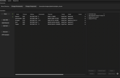

FPP Outputs State
	"channelOutputs": [
			"channelCount": -1,
			"enabled": 1,
			"interface": "eth0",
			"startChannel": 1,
			"timeout": 1000,
			"type": "universes",
			"universes": [
					"active": 1,
					"address": "192.168.68.159",
					"channelCount": 92160,
					"deDuplicate": 0,
					"description": "bedroompanel",
					"id": 2,
					"monitor": 1,
					"priority": 0,
					"startChannel": 1,
					"type": 4
					"active": 0,
					"address": "192.168.68.163",
					"channelCount": 258048,
					"deDuplicate": 0,
					"description": "bigscreenaudio",
					"id": 3,
					"monitor": 1,
					"priority": 0,
					"startChannel": 92161,
					"type": 4
					"active": 1,
					"address": "192.168.68.151",
					"channelCount": 6399,
					"deDuplicate": 0,
					"description": "front-house-left",
					"id": 1,
					"monitor": 1,
					"priority": 0,
					"startChannel": 350209,
					"type": 4
					"active": 0,
					"address": "192.168.68.158",
					"channelCount": 270000,
					"deDuplicate": 0,
					"description": "guestprojector",
					"id": 7,
					"monitor": 1,
					"priority": 0,
					"startChannel": 356608,
					"type": 4
					"active": 1,
					"address": "192.168.68.115",
					"channelCount": 6708,
					"deDuplicate": 0,
					"description": "front-house-wendy",
					"id": 9,
					"monitor": 1,
					"priority": 0,
					"startChannel": 626608,
					"type": 4
					"active": 1,
					"address": "192.168.68.122",
					"channelCount": 16479,
					"deDuplicate": 0,
					"description": "front-main-a",
					"id": 5,
					"monitor": 1,
					"priority": 0,
					"startChannel": 633316,
					"type": 4
					"active": 1,
					"address": "192.168.68.129",
					"channelCount": 12075,
					"deDuplicate": 0,
					"description": "front-main-b",
					"id": 10,
					"monitor": 1,
					"priority": 0,
					"startChannel": 649795,
					"type": 4
					"active": 1,
					"address": "192.168.68.125",
					"channelCount": 3705,
					"deDuplicate": 0,
					"description": "front-house-right-b",
					"id": 11,
					"monitor": 1,
					"priority": 0,
					"startChannel": 661870,
					"type": 4
					"active": 1,
					"address": "192.168.68.119",
					"channelCount": 12300,
					"deDuplicate": 0,
					"description": "front-house-right-a",
					"id": 12,
					"monitor": 1,
					"priority": 0,
					"startChannel": 665575,
					"type": 4
					"active": 1,
					"address": "192.168.68.121",
					"channelCount": 14073,
					"deDuplicate": 0,
					"description": "back-tree-a",
					"id": 13,
					"monitor": 1,
					"priority": 0,
					"startChannel": 677875,
					"type": 4
					"active": 1,
					"address": "192.168.68.128",
					"channelCount": 15264,
					"deDuplicate": 0,
					"description": "back-tree-b",
					"id": 14,
					"monitor": 1,
					"priority": 0,
					"startChannel": 691948,
					"type": 4
					"active": 1,
					"address": "192.168.68.134",
					"channelCount": 10818,
					"deDuplicate": 0,
					"description": "back-main-a",
					"id": 15,
					"monitor": 1,
					"priority": 0,
					"startChannel": 707212,
					"type": 4
					"active": 1,
					"address": "192.168.68.150",
					"channelCount": 4533,
					"deDuplicate": 0,
					"description": "boobs",
					"id": 8,
					"monitor": 1,
					"priority": 0,
					"startChannel": 718030,
					"type": 4
					"active": 1,
					"address": "192.168.68.130",
					"channelCount": 9024,
					"deDuplicate": 0,
					"description": "back-main-b",
					"id": 16,
					"monitor": 1,
					"priority": 0,
					"startChannel": 722563,
					"type": 4
					"active": 1,
					"address": "192.168.68.126",
					"channelCount": 510,
					"deDuplicate": 0,
					"description": "housebaldrick",
					"id": 1,
					"monitor": 1,
					"priority": 100,
					"startChannel": 731587,
					"type": 1,
					"universeCount": 2

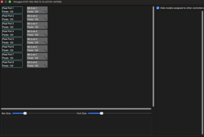

Wrong pixels are lighting up when played from FPP
Normally this indicates that something has changed on the layout but FPP hasn't been updated, if you can re-render the sequence then save, then FPP Connect and make sure UDP Out is set to ALL.
