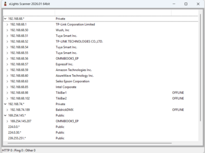

Board has an address recognized by xLights Scanner, but it shows off line.
Open
When I initially got the board, I pressed the button to wake it - nothing happened. I typed http://baldrickdmx local into my Chrome browser, no response "this site can't be reached" I typed the address 192.168.74.189 and got "Can't be reached took too long". I tried resetting to factory by pressing the button for 5 seconds while applying power. Nothing changed on the board's lights to indicate a reboot. Nothing changed on the board status or ability to connect. With power on, the Power LED is lit (green) and there are is a blinking left LED and solid right LED on the network connection.
