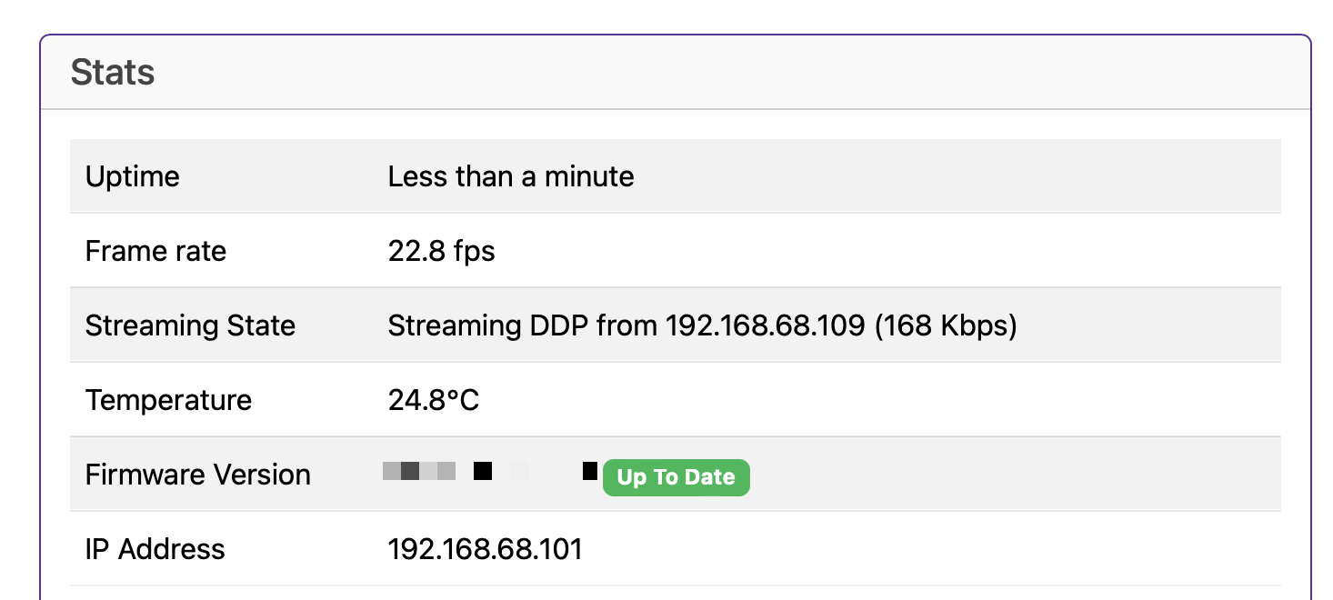

Baldrick17 Web Interface Stats
This lets you know what the FPS (Frames Per Second) the controller is currently outputting (The Baldrick17 has been optimised to output up to 2250 channels per port (which is 750 RGB pixels at 40fps))
Will indicate if the board is receiving data from a specific IP address and what type of data. The board will also show if two IPs are streaming to the board at the same time which is very useful for debugging those pesky problems

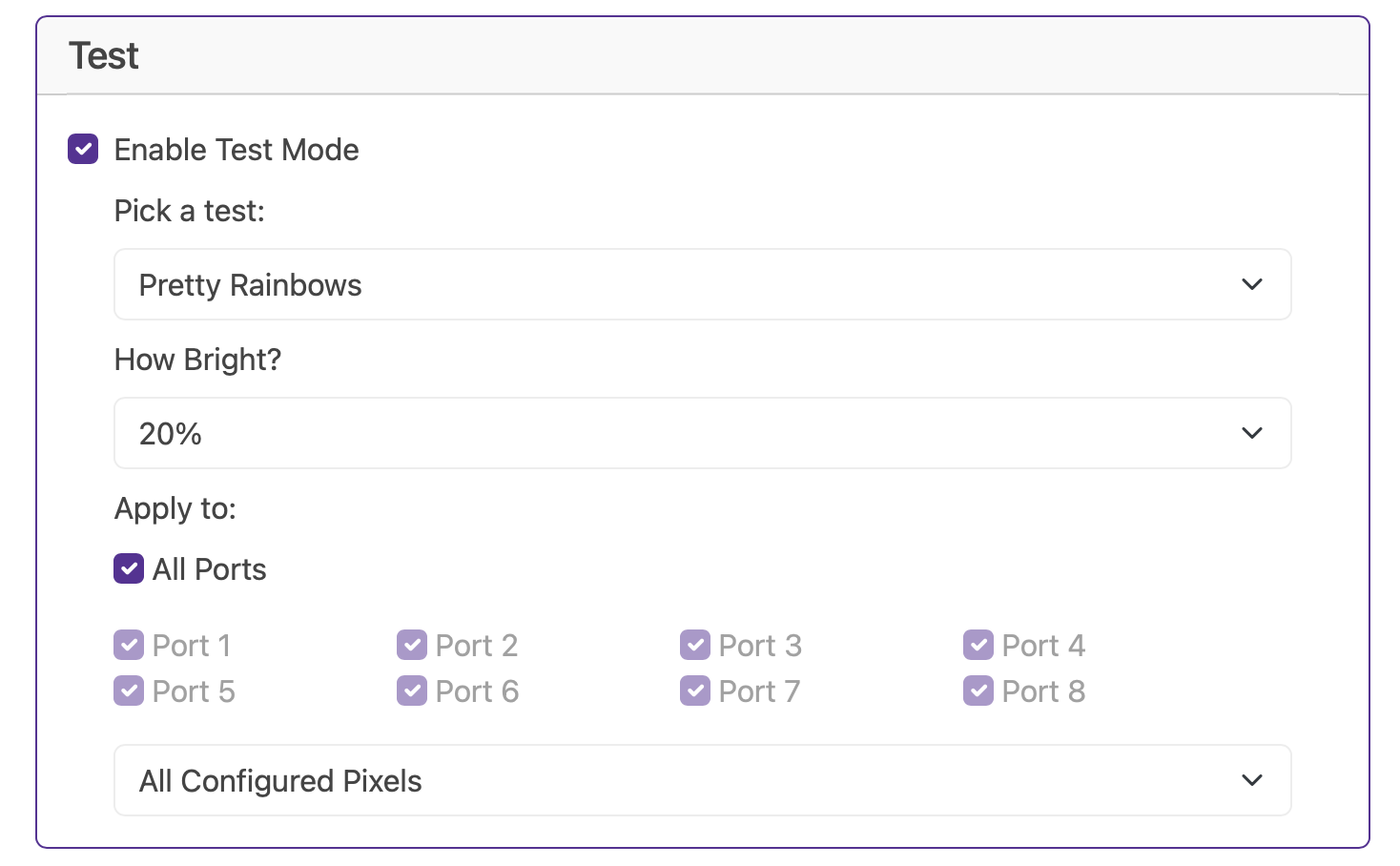

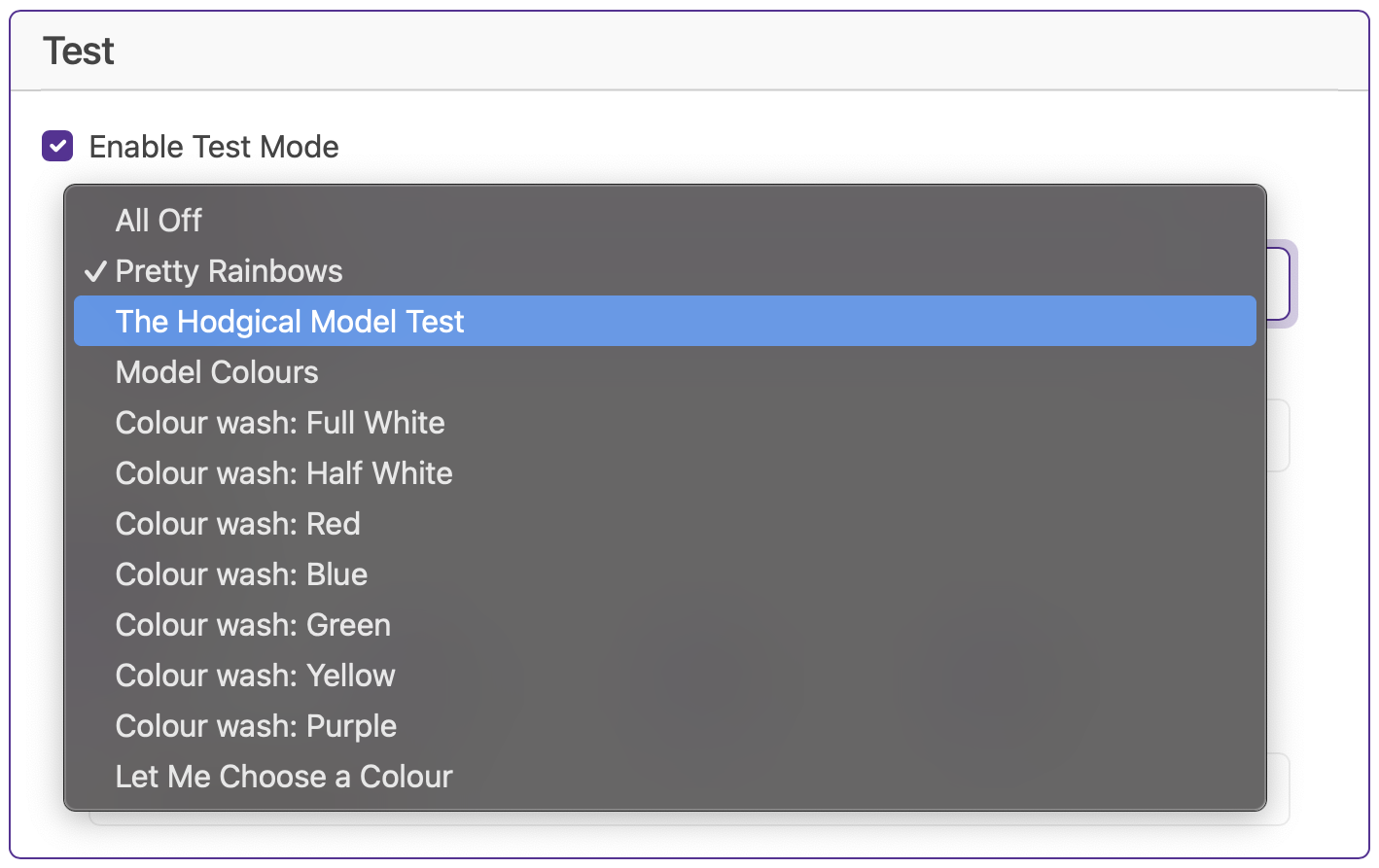

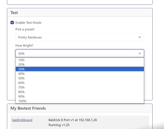

Test mode is one of the most important features of the Baldrick Board, if it’s two hours before switch on and something is going wrong, YOU NEED CLEAR INFORMATION QUICKLY.
Baldrick17 Web Interface Test
Colour Presets
We’ve created a bunch of presets to help you with your testing but we got bored with just writing colours so we thought we’d have some fun with the names. You might want to have a look at something special we’ve introduced called Hodgical Mode
Test Presets
Brightness
Sometimes 100% is too much Have you done those power calculations correctly? so we give you the choice of brightness.
Brightness Control

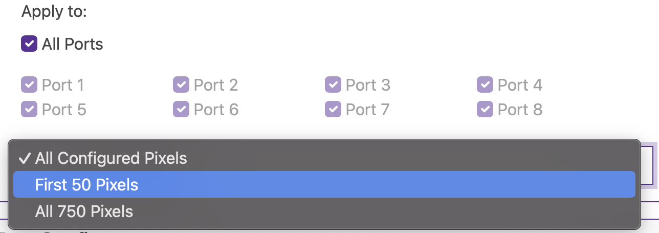

Apply to
Select your port (or all ports) then select if you want ALL configured pixels, 750 RGB pixels or 50 pixels.
Apply to Specific Areas

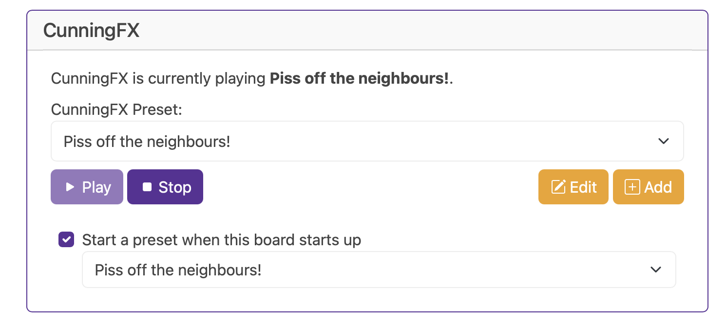

Visual Effects Generator
Baldrick17 Web Interface CunningFX
With more and more of our community putting pixels on their house all year round or producing lightart, we’ve produced CunningFX for you to add pretty stuff to your show without a show player.

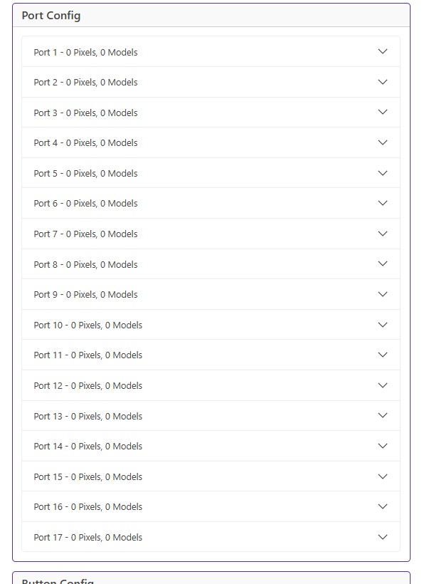

Manual Port Setup
Baldrick17 Web Interface Ports
Let’s be honest, most of the time you are going to be using xLights to play with your ports but if you want to be a strong independent person, you can drill down into each port, monitor and configure the models, the pixel count and brightness.

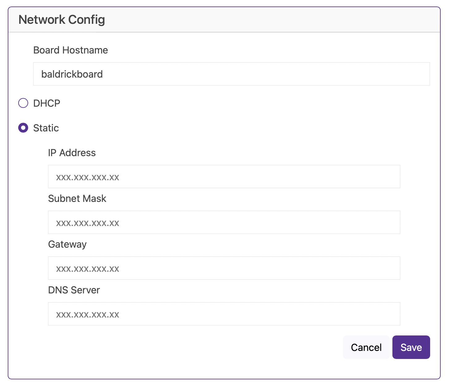

Baldrick17 Web Interface Networking
The default hostname is baldrickboard (hence baldrickboard.local). If you have one Baldrick17 then it’s completely fine to keep this as it is, however if like us you want to collect a few of them, then we’d recommend you change this to something like frontgarden or upstairsroof

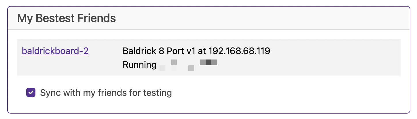

Baldrick17 Web Interface Friends
The Baldrick17 will keep an eye out on the network for other Baldricks and let you know how they are doing (this is helpful as we don’t put an LCD screen on the board).
Test Sync
Ticking this box will sync the test mode between all compatible boards, meaning if you are doing something on the house and want all your baldricks in Test Mode, it’s very easy to do!

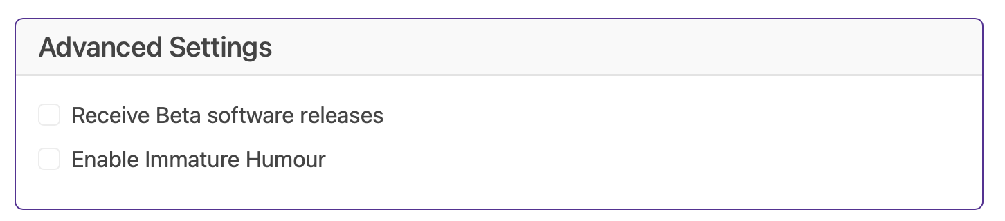

Baldrick17 Web Interface Advanced
We avoided it for so long but it’s finally time to have a “box to stick stuff that doesn’t fit in the other categories” and here it is, Advanced Settings.
Receive Beta Software Releases
Sometimes features need a bit more testing before we are ready to push them out to the wider world, if you like living on the edge (or just like being nosey).
Enable Immature Humour
Some of our vendors love the board but do NOT appreciate our humour and so asked to remove the childish brightness names and test modes. This setting lets those customers WHO BELIEVE IN FREEDOM turn them back on.

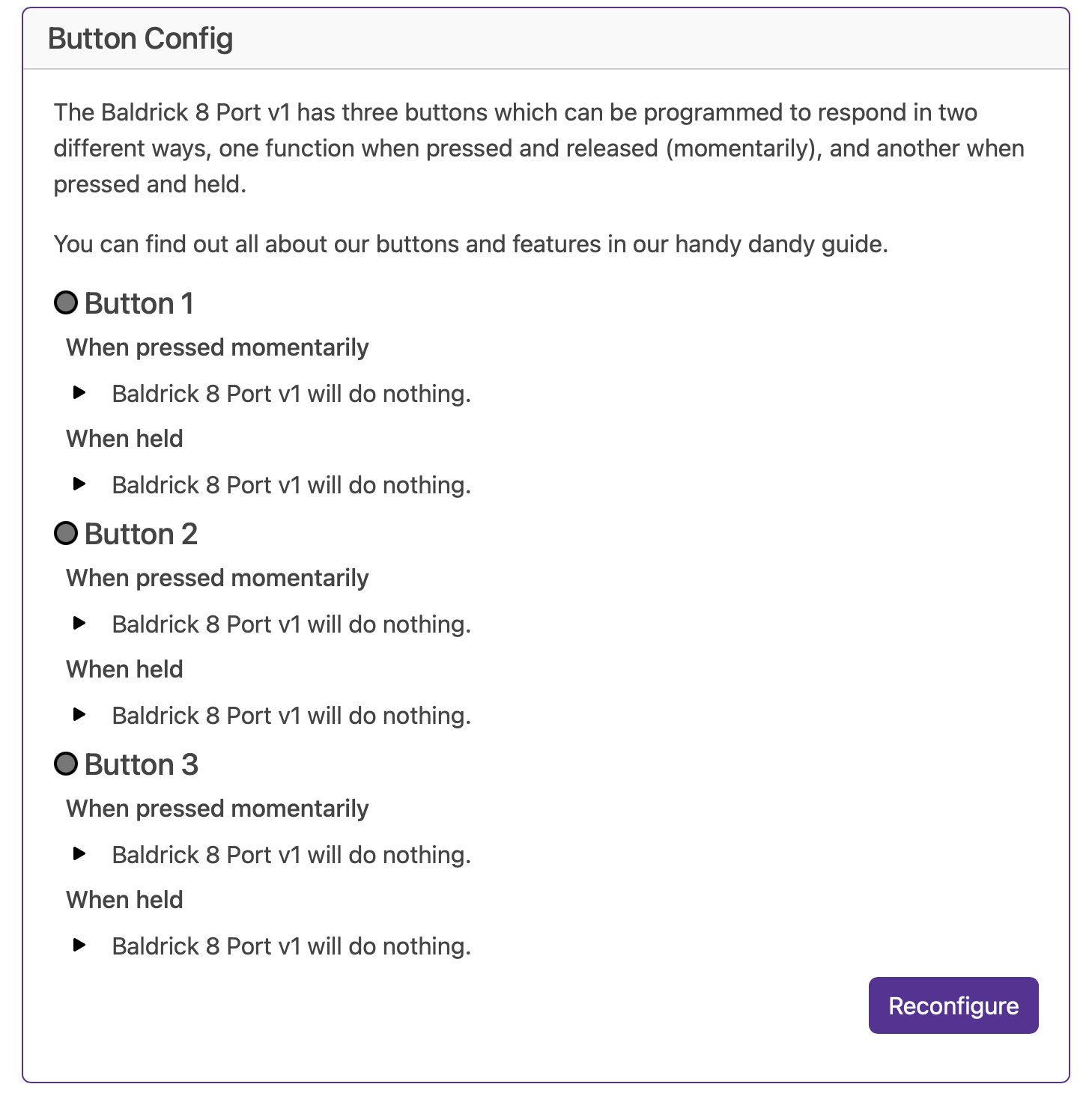

Turniputs (Inputs)
The Baldrick17 comes with three turninputs to attach external triggers (buttons, beam breaks, motion sensors) that can be configured when triggered to do a multitude of tasks.
Baldrick17 Web Interface Buttons

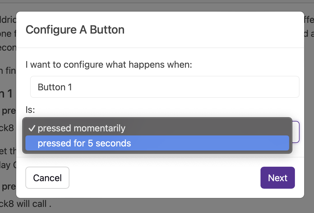

Each input has two action states - either pressed instantly or held. When an input is in the active state, the interface will show the status by highlighting the LED.
Button Pressed State
Control FPP (Falcon Pi Player) instances, change volume, play songs/playlists, or call FPP API directly.
Quickly enable any test mode at a specific brightness for quick prop testing.
Turn on/off BaldrickSwitchy ports for specific durations (bubble machines, snow machines, etc.).
Activate preset commands on your BaldrickDMX for moving heads, effects, etc.

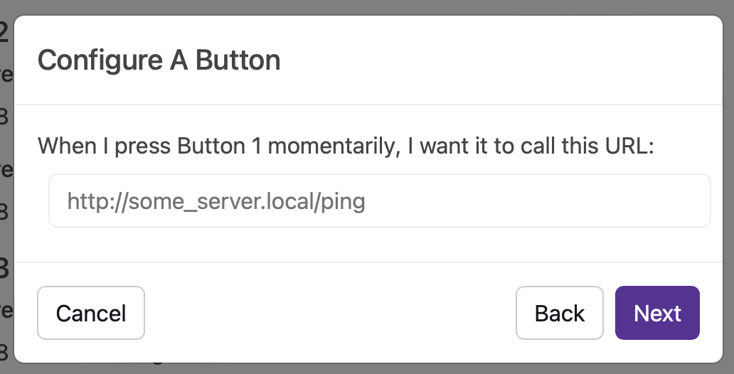

Call web APIs from simple triggers - perfect for custom integrations.
Sometimes you set an input to do something and think “oh actually no, that’s not what I want.”

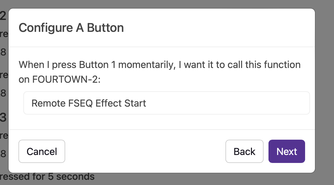

FPP Integration Details
FPP (or Falcon Pi Player) is our recommended show player for the holiday lighting hobby. It has some really powerful functionality and is simple to setup and use, that power also extends to its API which allows people to do some really cool stuff. But we don’t think you should have to learn the API to do that cool stuff.
We’ve two ways of using FPP which have proper names but let’s call them ‘Easy’ (Control an FPP Instance) and ‘Advanced’ (Call an FPP API Directly).

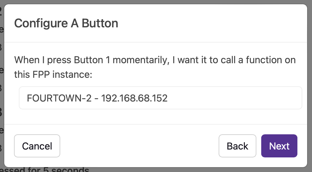

FPP Instance Discovery
Both start off the same way by selecting the FPP instance that you’d like to interact with. If we can’t find it automatically you can put in an IP address (although it might be worth finding out why we can’t find it as it will be pretty hard to send commands to something we cannot find).
This section takes away having to use the scary API to ask FPP to do some things. For our initial version you can change the volume of FPP (either forever or for a period of seconds) or play a song / playlist / random song from a playlist.
Sorry did I say or I meant AND. You can do both of these, with one input and we will even pull in live your sequences and playlists direct from FPP.
FPP Instance Control
If you want to get your hands dirty with FPP commands, here it is - almost everything you can do via the API direct and configurable to be executed via a Baldrick17 input!
FPP API Commands

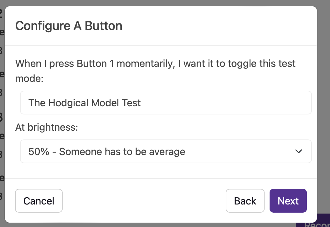

Test Mode Activation
Sometimes you just want to quickly test how the props look (or put something up when the neighbors pop round to ‘see how it’s going’). You can quickly enable any of our test modes at a specific brightness with the touch (or activation) of an input.
Test Mode Configuration
