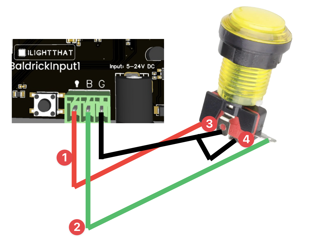

It’s time to wire up the input, in this example we are going to use a button but the Input1 will work with many different types of sensors.
Button Wiring Diagram
Wiring Connections
  1. Lamp - This should be attached to the + side of your button LED (if not using a button with an LED this can be ignored)
  2. Button - This should be attached to the switch section of the button or input
  3. Ground button - This should be attached to the ground section of the button or input
  4. Ground lamp - This should be attached to the ground section of the lamp (normally we just link the ground of the button to this)
The BaldrickInput1 supports various input types including buttons, motion sensors, reed switches, beam breaks, and other input devices.

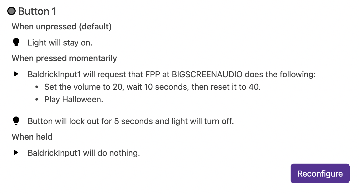

Configuring Your Input Response
Now it’s time to configure what happens when your input is triggered. This is where the magic happens!
Input Configuration
  <h6>FPP Integration</h6>
  <h6>HTTP URL Calls</h6>
The BaldrickInput1 includes lamp control capabilities, so you can also control a physical lamp or LED indicator when your input is triggered.
