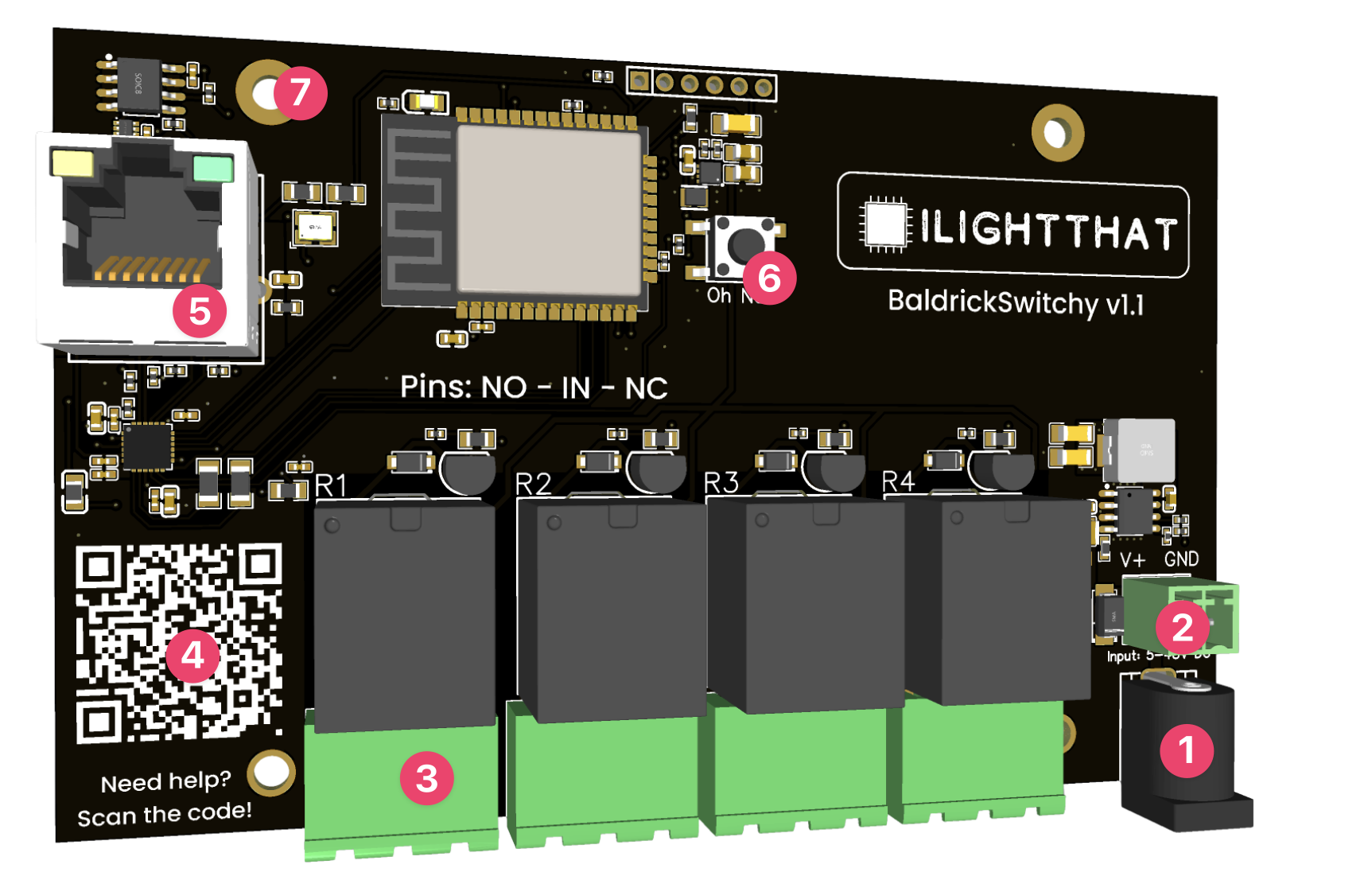

<div class="tab-panel" data-tab="v1-1">
  <div class="figure">
    <div class="fimg">
      <img src="baldrickswitchy/breakdown11.png" alt="BaldrickSwitchy v1.1 Board Overview" class="doc-img">
    </div>
  </div>
  <ul>
    <li><strong>1. Power Jack —</strong> You can put 5v-48v through a barrel connector (centre positive) and we use 5.5x2.1mm barrel jacks. Please remember you are just powering the board not the devices.</li>
    <li><strong>2. 2 Pin Pheonix Connector —</strong> You can put 5v-48v through this connector. Please remember you are just powering the board not the devices.</li>
    <li><strong>3. 3 Pin Relays —</strong> Connect your device to enable control via the BaldrickSwitchy.</li>
    <li><strong>4. QR Code —</strong> An easy to scan QR code which will take you to these docs for quick troubleshooting.</li>
    <li><strong>5. Ethernet port —</strong> To ensure the consistent connection to your devices, we've added a 100mb ethernet port to connect to your show network.</li>
    <li><strong>6. Oh No Button —</strong> Did you break our board? Press and hold this for 5 seconds on boot to reset to factory settings.</li>
    <li><strong>7. Mounting Holes —</strong> The BaldrickSwitchy is classed as a medium family member.</li>
  </ul>
