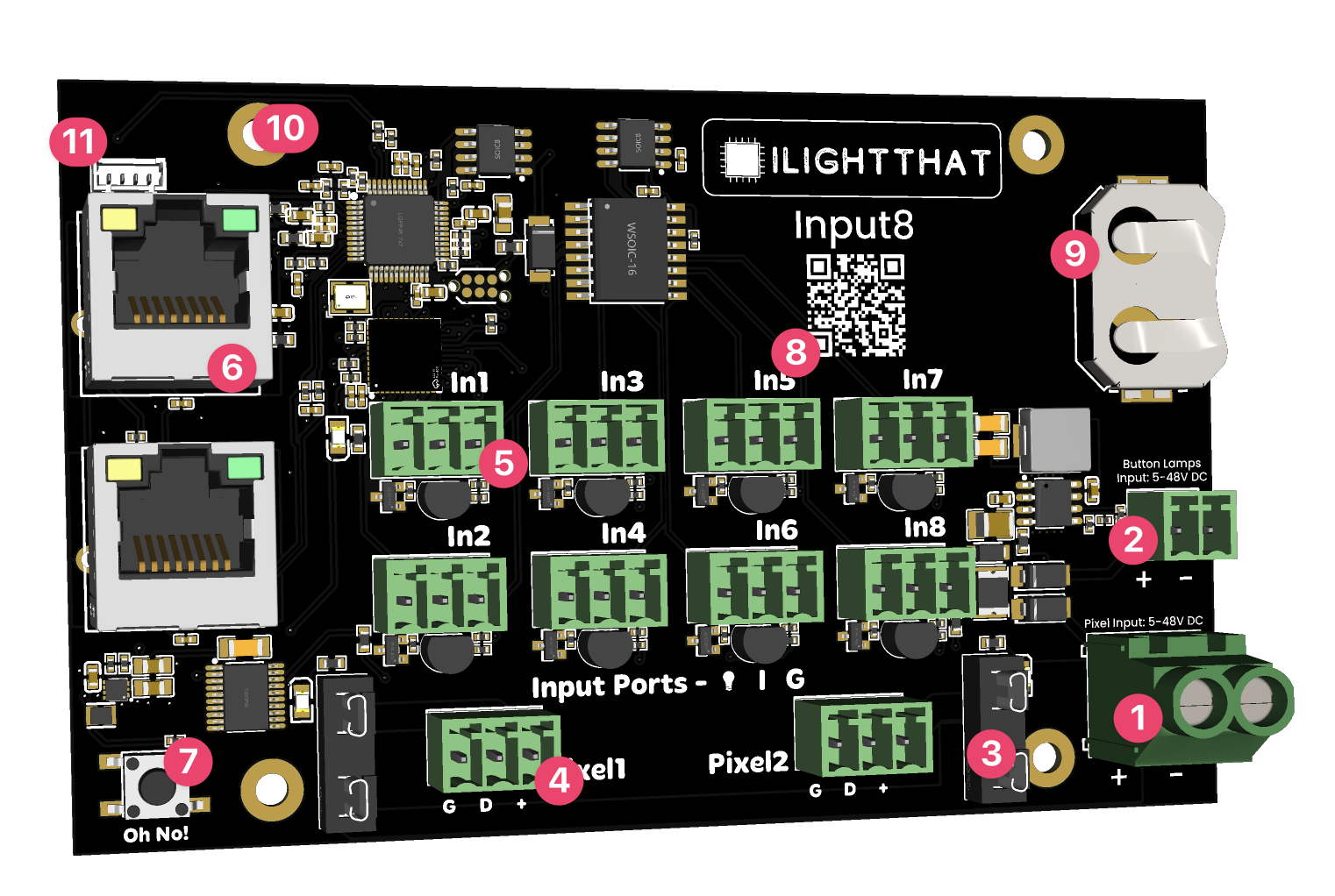

Board components and detailed specifications for BaldrickInput8
Board Components
BaldrickInput8 Board Overview
  1. Pixel Power Jack - Can take 5v to 48v and will automatically step down to power the board.
  2. Lamp Power - Working on the basis that you might want 12v pixels but 5v lamps in your buttons, we've added a separate power for your lamps (if you don't use lightup buttons you can ignore this).
  3. 7.5amp fuse - Nothing much to say here.
  4. Pixel output - Can output up to 750 RGB pixels at 40FPS.
  5. Turniputs - Our advanced input powered by the Turnip Network.
  6. Dual 100mb Ethernet Port - You can use this to connect to your show network then daisy chain something else (like a Baldrick17 or a BaldrickSwitchy).
  7. Oh No button - Use this to reset the board by holding for 5 seconds when the board is booting.
  8. QR Code - An easy to scan QR code which will take you to these docs for easy troubleshooting.
  9. RTC battery - Keeps the time even if not connected to the internet, perfect for scheduling effects to go on and off at certain times.
  10. Mounting Holes - The BaldrickInput8 is classed as a medium family member.
Note: The BaldrickInput8 is designed as a medium family member, making it compatible with existing mounts and enclosures from other Baldrick boards.
