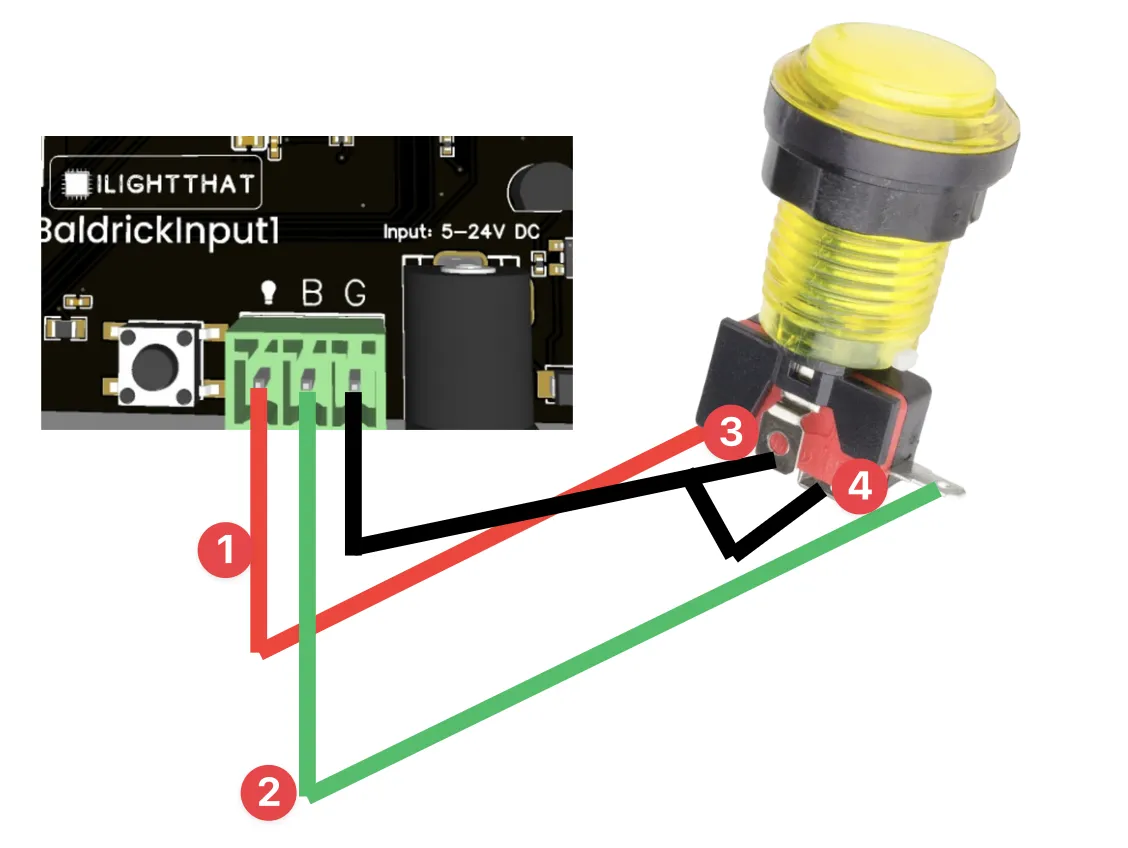

Connecting Your Input Device
It’s time to wire up the input, in this example we are going to use a button but the Input1 will work with many different types of sensors.
Button Wiring Diagram
Wiring Connections
  1. Lamp - This should be attached to the + side of your button LED (if not using a button with an LED this can be ignored)
  2. Button - This should be attached to the switch section of the button or input
  3. Ground button - This should be attached to the ground section of the button or input
  4. Ground lamp - This should be attached to the ground section of the lamp (normally we just link the ground of the button to this)
The BaldrickInput1 supports various input types including buttons, motion sensors, reed switches, beam breaks, and other input devices.

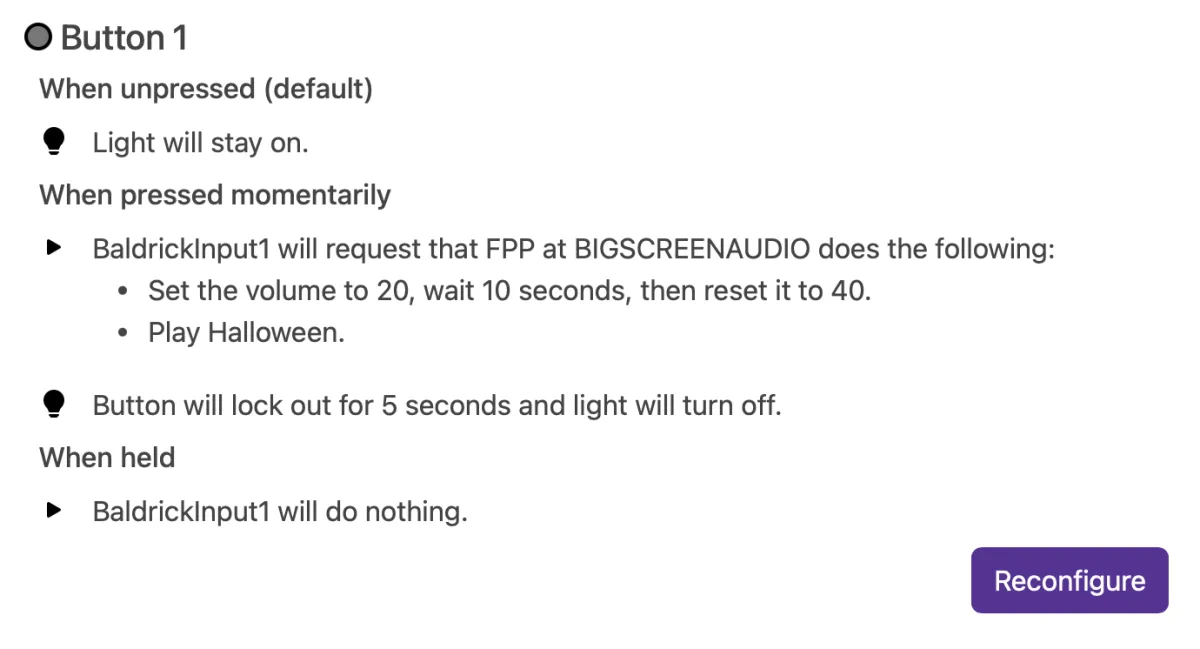

  <h6>FPP Integration</h6>
  <h6>HTTP URL Calls</h6>
The BaldrickInput1 includes lamp control capabilities, so you can also control a physical lamp or LED indicator when your input is triggered.

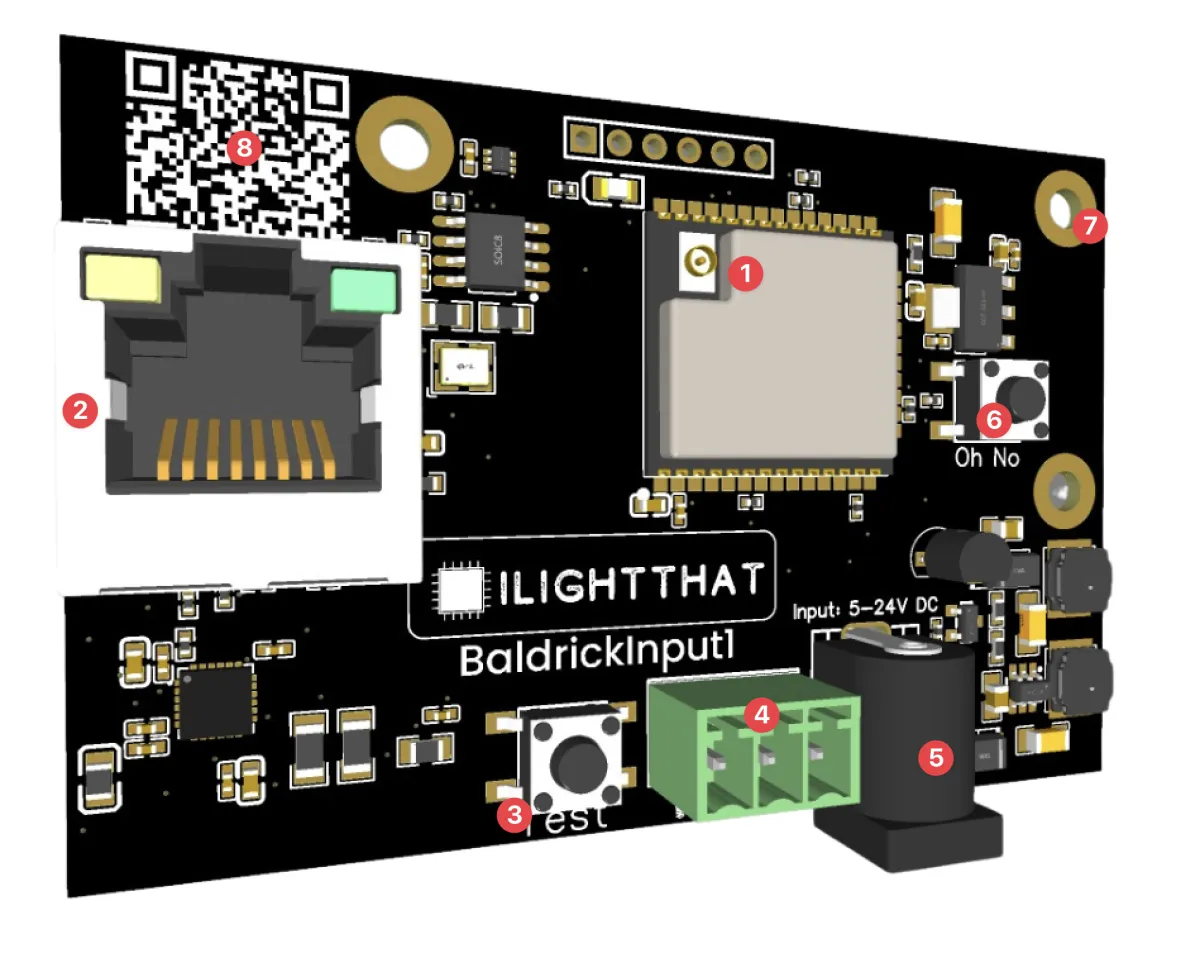

BaldrickInput1 Board Overview
  1. Wireless Chip — The BaldrickInput1 can run on either Wifi or Ethernet (but to get the wifi working, you’ll need an antenna).
  2. 100mb Ethernet Port — You can use this to connect to your show network.
  3. Test Button — Use this to test what you’ve setup.
  4. Turniput — Connect a button, motion sensor, beambreak or anything here to trigger an effect (it also has an output for lamp control).
  5. Power Jack — Can take 5v to 24v (each side can take different voltages) and will automatically step down to power the components, no jumpers needed. Whatever voltage you used here is also used to power the lamp.
  6. Oh No button — Use this to reset the board by holding for 10 seconds when the board is booting.
  7. Mounting Holes — The BaldrickInput1 is classed as a small family member.
  8. QR Code — An easy to scan QR code which will take you to these docs for easy troubleshooting.
DO NOT DRILL out these holes to make them fit the screws you’ve got already, doing this will void any warranty.

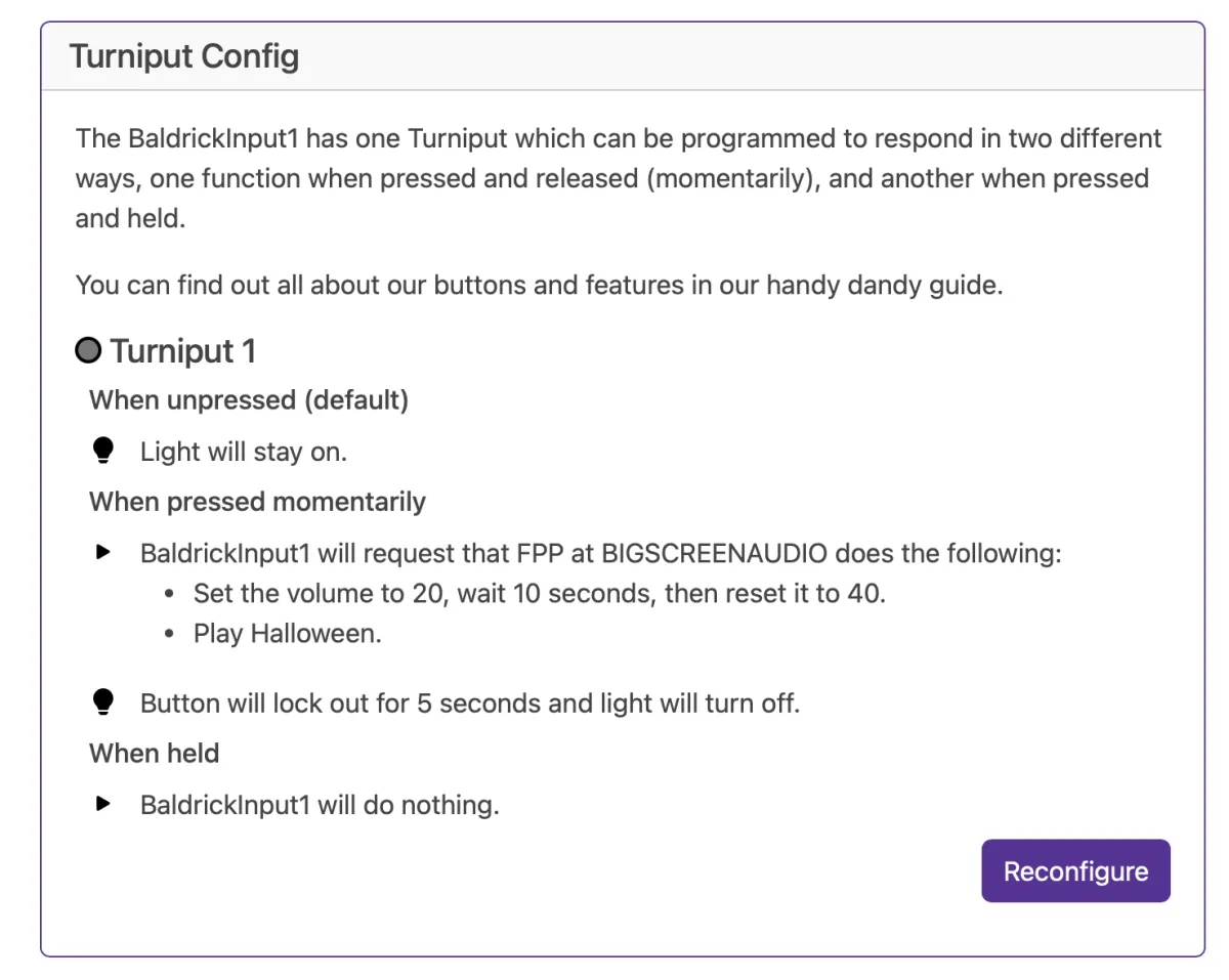

BaldrickInput1 Turniput Configuration
The BaldrickInput1 comes with a single Turniput port to attach external triggers (buttons, beam breaks, motion sensors) that can be configured when triggered to do a multitude of tasks.
The main difference between this and the Button input on the Baldrick8 is the addition of Lamp controls.
