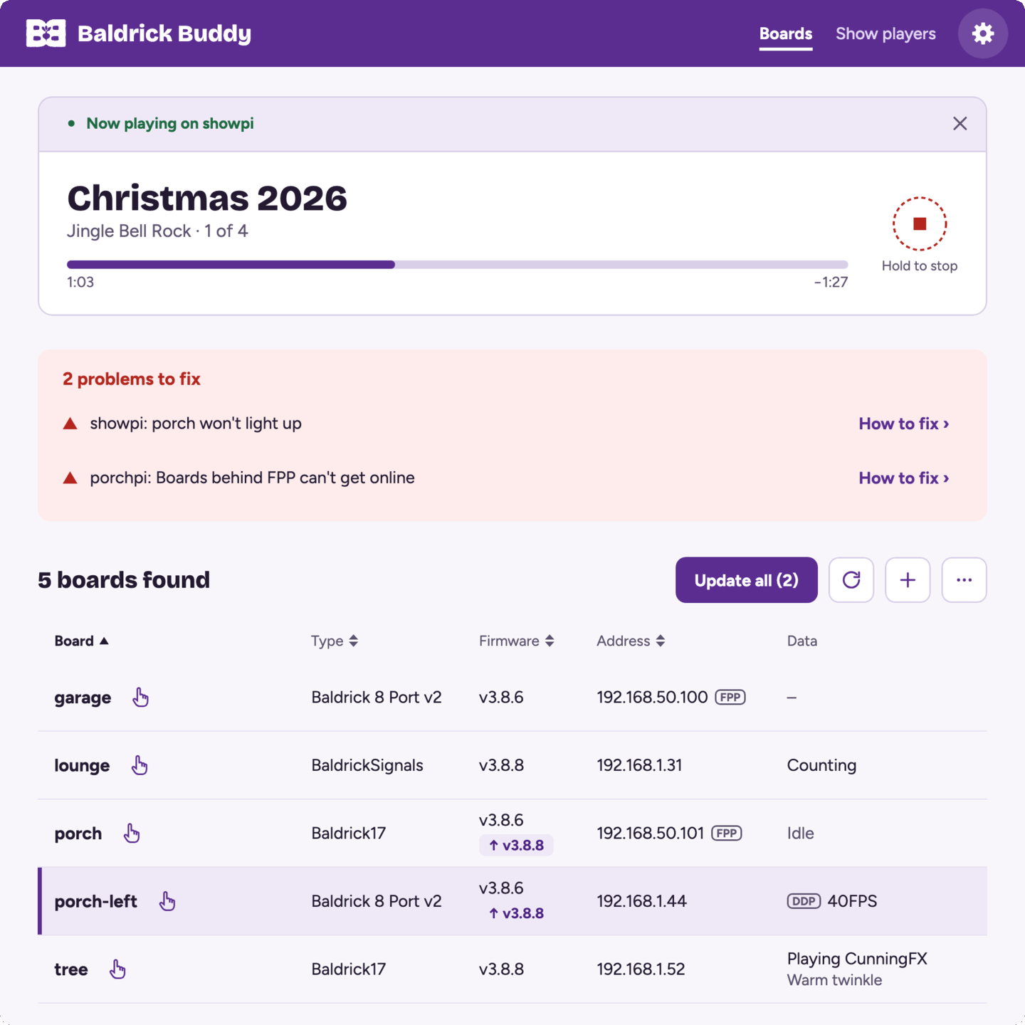

OverviewEvery board, at a glance
Buddy finds your boards by itself and lists each one with its type, firmware and address, and what it's getting right now: DDP at 40FPS, a CunningFX preset playing, or people being counted on a BaldrickSignals board. Anything that needs fixing is at the top. If your main show player is running, you'll see what it's playing too, with Hold to stop.
The Boards page in Baldrick Buddy: Christmas 2026 playing on showpi with Hold to stop, two problems to fix, and five boards with their type, firmware, address and incoming data
Two boards behind an FPP, two waiting for v3.8.8, and one playing a CunningFX preset.
  • Boards Buddy has seen before are listed as soon as it opens, and one that stops answering is marked.
  • Update all updates every board that needs it, in one go.
  • Poke lights a board up for five seconds, so you can find the right box in the loft.
  • Add a board by its address, or have Buddy scan other subnets and VLANs your computer or phone can reach.
  • With a lot of boards, search and filter the list, or sort it by any column.

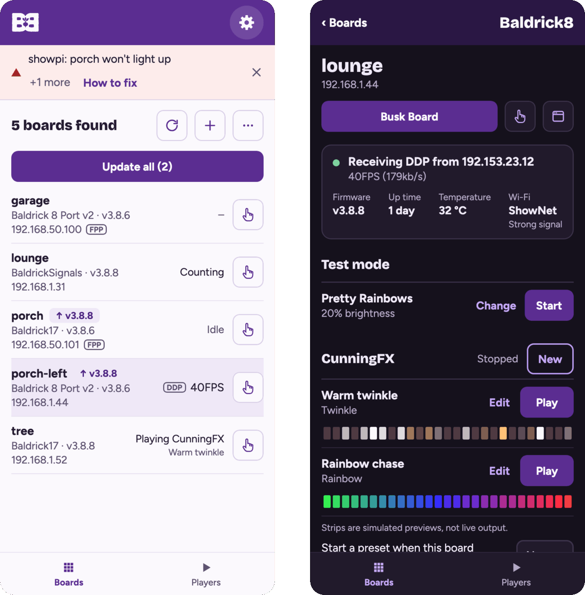

Baldrick Buddy on a phone: the board list in light mode, and a board page with test mode and CunningFX in dark mode
The same app on your phone, in light or dark to match it.

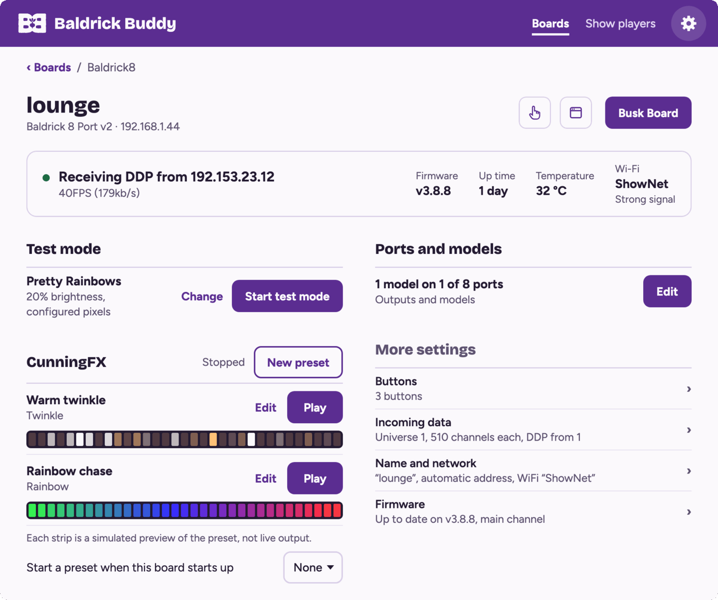

Click a board to open its page. It shows what the board is receiving, its temperature and Wi-Fi signal, and everything you can do with it.
A Baldrick 8 Port board page: receiving DDP at 40FPS, test mode, CunningFX presets with preview strips, ports and models, and more settings
Each CunningFX preset has a preview strip, so you know what it looks like before you press Play.

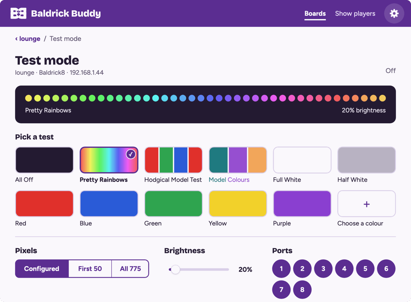

Test mode
Each test is a tile that shows what it does, with a preview that moves the way the test will. Pick a colour, which pixels, the brightness and the ports. While a test is running, every change goes to the board straight away, so you can check your wiring without walking back to the computer.
Test mode in Baldrick Buddy: a Pretty Rainbows preview, tiles for each test and colour, and choices for pixels, brightness and ports

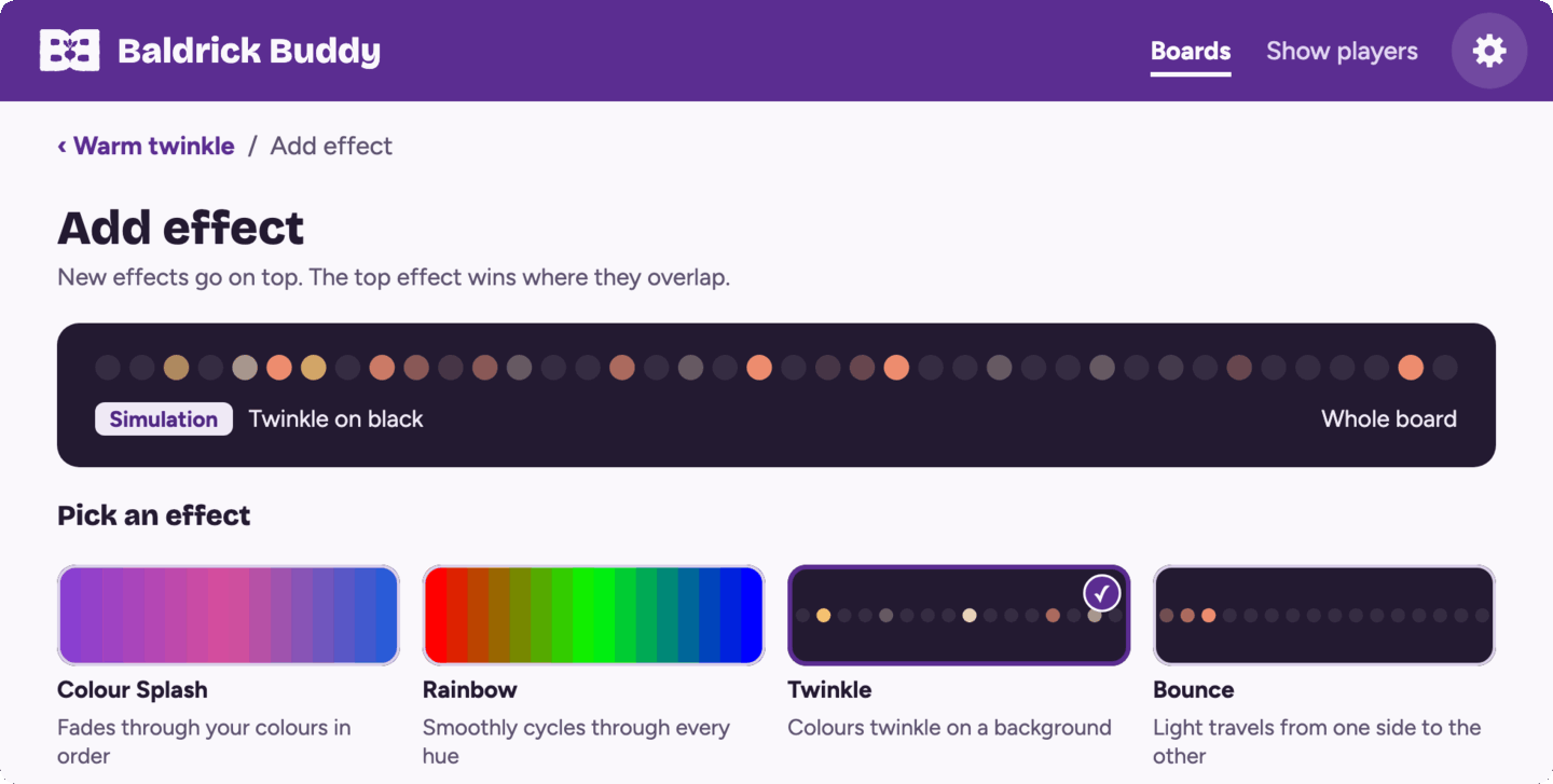

Build effects on the board itself, no sequencer needed. Every effect comes with a plain description and a simulated preview worked out from the board's own effect code. Stack effects in layers, choose colours and speed, or press Randomise (or shake your phone) to try something new. Choose a preset to start when the board powers up.
Adding a Twinkle effect to a CunningFX preset, with a simulated preview and tiles for Colour Splash, Rainbow, Twinkle and Bounce

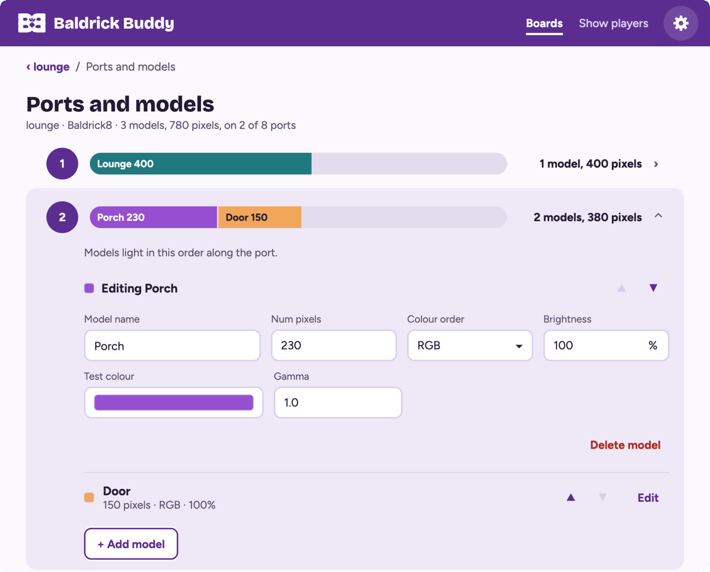

Ports and models
Each port is drawn as a bar of its models in the order they light, so a missing model or a wrong pixel count stands out. Open a port to add, change or reorder its models: name, pixel count, colour order, brightness, gamma and test colour.
Ports and models in Baldrick Buddy: port 1 with Lounge, port 2 with Porch and Door, and the Porch model open for editing

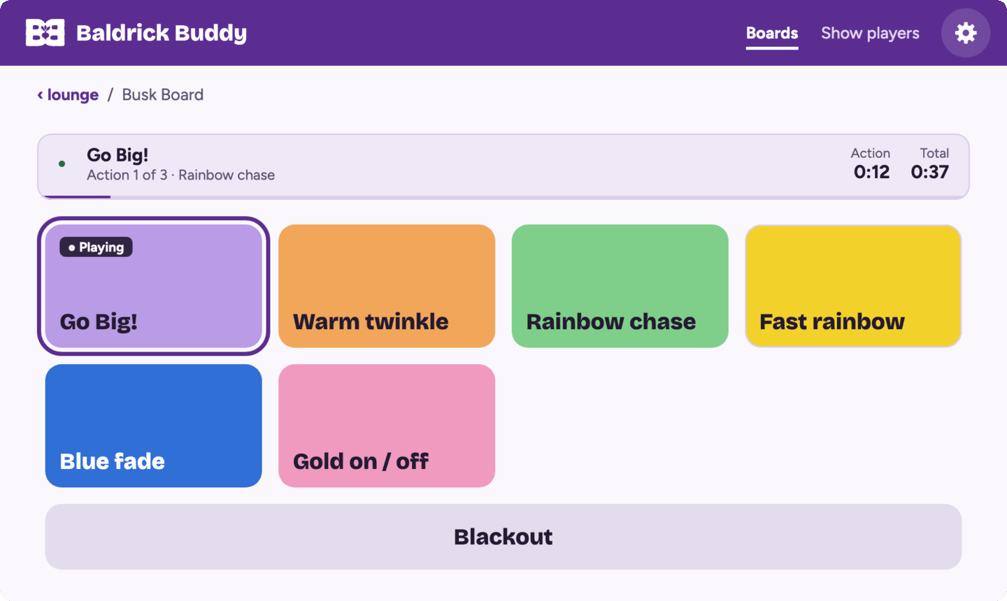

Busk Board
Big pads for running looks live, from your phone or computer. One runs at a time, with a bar showing what's playing and how long is left, and Blackout is always one tap away.
The Busk Board in Baldrick Buddy: Go Big! playing, with pads for Warm twinkle, Rainbow chase, Fast rainbow, Blue fade and Gold on / off, and a Blackout button

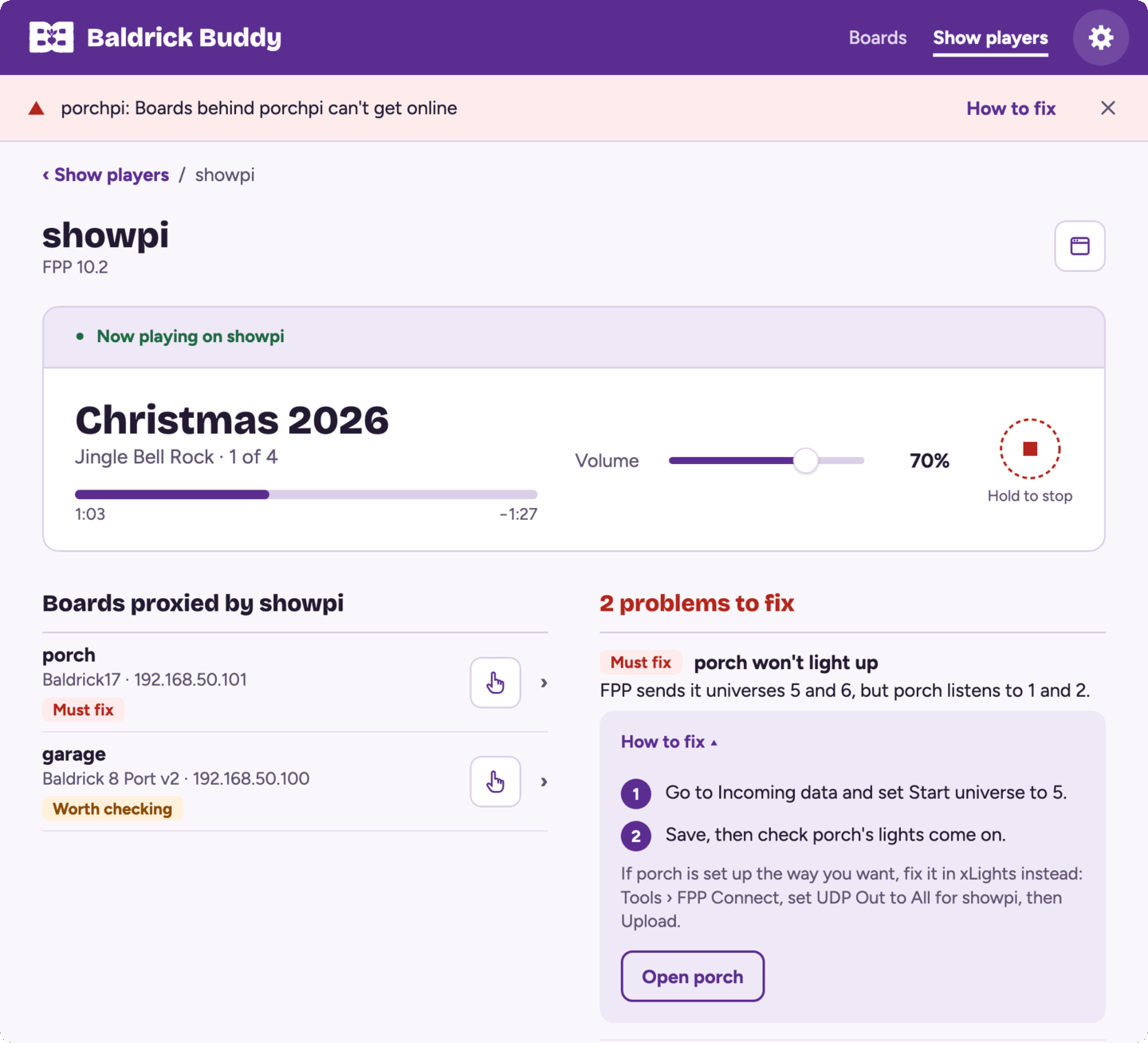

FPPWorks with your show player
The Show players tab finds the FPPs (Falcon Player) on your network. Each one has a page with what it's playing and its volume, the boards behind it, its own warnings and its CPU temperature, with a nudge if it's running hot. Buddy then checks the two things that most often stop a show working.
An FPP called showpi in Baldrick Buddy: Christmas 2026 playing, the two boards it proxies, and a problem explained with numbered steps to fix it
FPP sends porch universes 5 and 6, but porch listens to 1 and 2. Buddy says how to fix it on the board or in xLights.
  • Why a board won't light up. Buddy compares what FPP sends each board with how the board is set up: outputs switched off, the wrong universes, too few channels, or DDP and E1.31 at once.
  • FPP Proxy. Boards plugged into an FPP's second network port appear in your board list and can be updated through the FPP. Buddy checks how the proxy is set up and tells you, step by step, what to change. More about FPP Proxy.

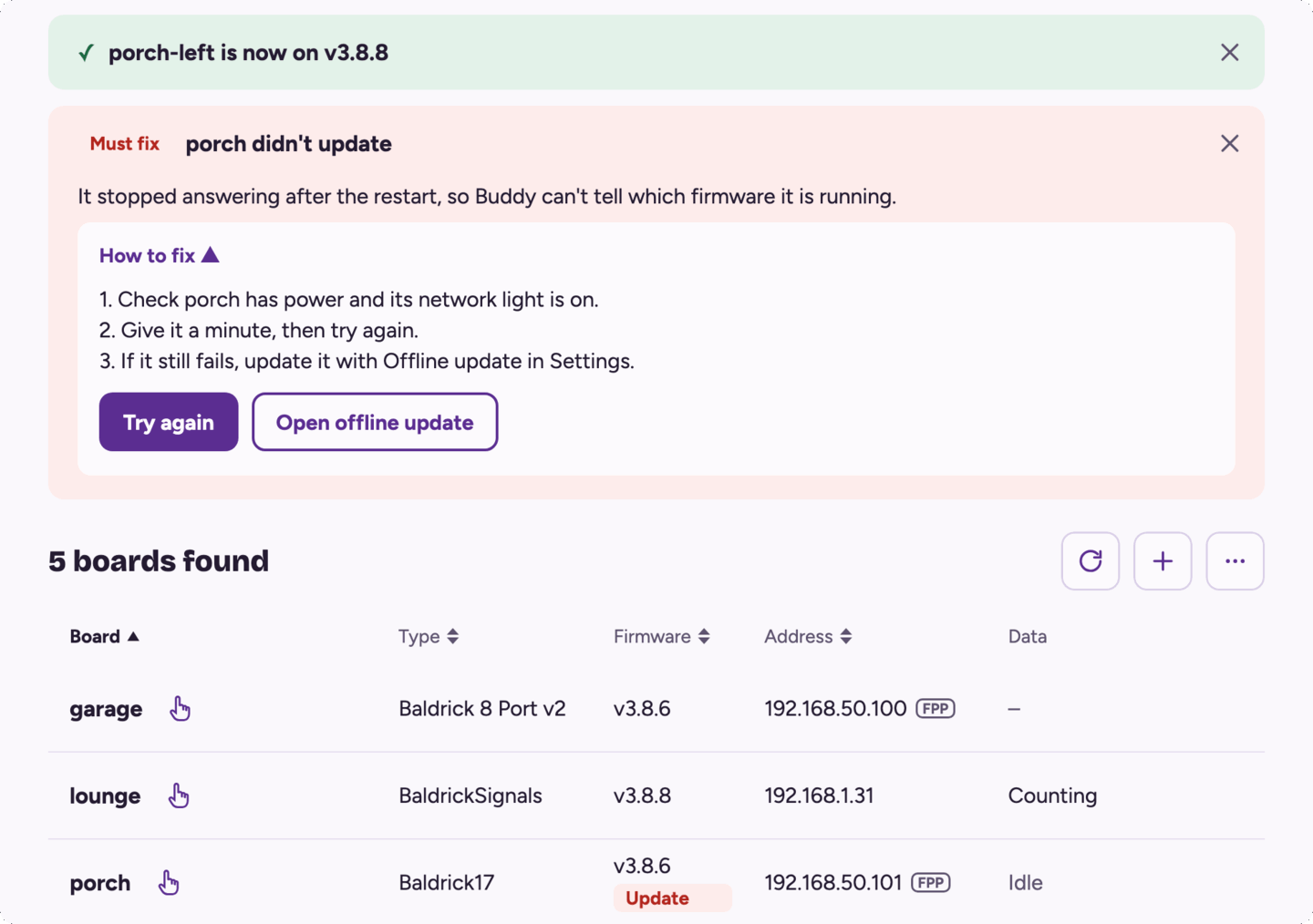

UpdatesFirmware updates you can follow
When new firmware is out, it shows against the board in the list. Update one board or all of them, including the ones behind an FPP, and follow each one until it's back: "porch-left is now on v3.8.8", or what went wrong and what to try next.
Update results in Baldrick Buddy: porch-left is now on v3.8.8, and porch didn't update, with steps to fix it, Try again and Open offline update
  • Move boards between the main, beta and commercial release channels, one at a time or several at once.

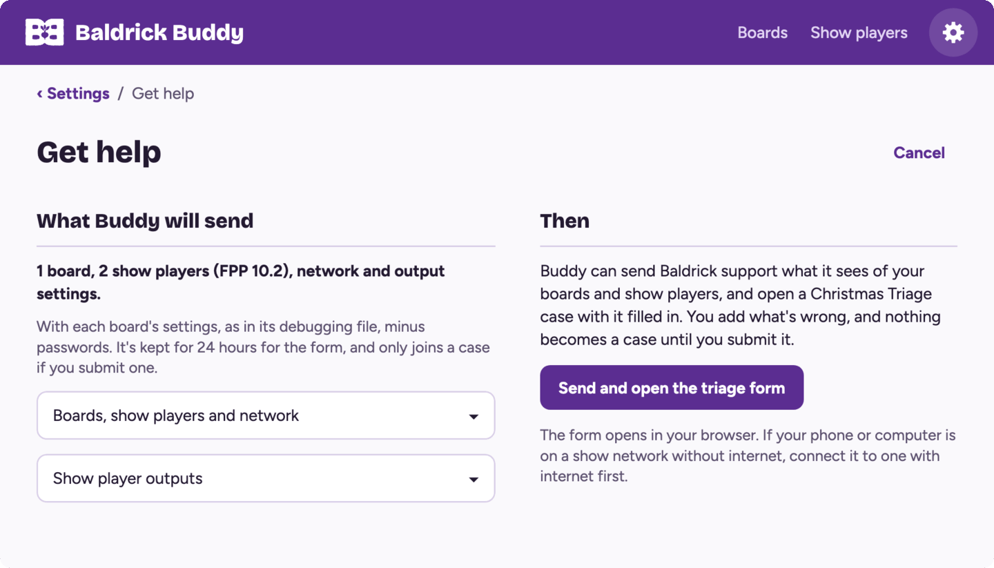

HelpGet help without the back and forth
When you're stuck, Get help collects what Buddy can see of your boards and show players: board types, firmware, FPP version, and network and output settings. It watches them for 30 seconds to catch data dropping out or a board restarting, then opens a Christmas Triage case on this site with all of that filled in. You just say what's wrong.
Get help in Baldrick Buddy: what Buddy will send, and a button to send it and open the triage form
Nothing is sent until you press Send, and passwords are never included.
