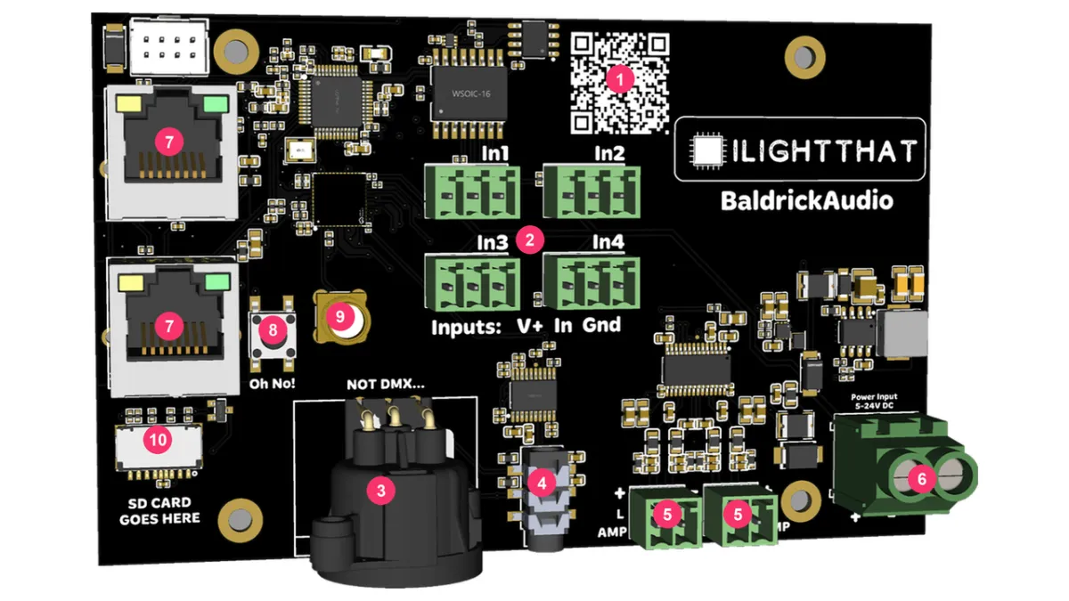

BaldrickAudio board overview with numbered parts
  1. QR Code — An easy to scan QR code which will take you to these docs for easy troubleshooting.
  2. Inputs (In1 to In4) — Connect buttons and sensors to trigger your sounds. Ordered V+, In, Gnd.
  3. Pre-amp output, 3 pin XLR — Line level audio for your own amp or powered speakers. It’s marked NOT DMX… for a reason.
  4. Pre-amp output, 3.5mm jack — The same pre-amp signal on a headphone-style jack.
  5. Speaker outputs (L AMP and R AMP) — 2 port Phoenix connectors from the built-in 25W amp.
  6. Power Input — 5v - 24v DC, steps down to power the components.
  7. Ethernet ports — Two 100Mb ports joined by a built-in switch. Plug one into your show network and use the other to daisy-chain to your next board.
  8. Oh No! button — Did you break our board? Press and hold this for 10 seconds on boot to reset to factory settings.
  9. WiFi antenna connector — Screw on an external WiFi antenna for Busk Board, CunningFX and board control over WiFi.
  10. SD card slot — Where your sound files live. FAT32, tested up to 32GB.
The BaldrickAudio has the same medium footprint as the Baldrick8, so you can reuse your Baldrick8 bases and mounts. DO NOT DRILL out these holes to make them fit the screws you’ve got already, doing this will void any warranty.
