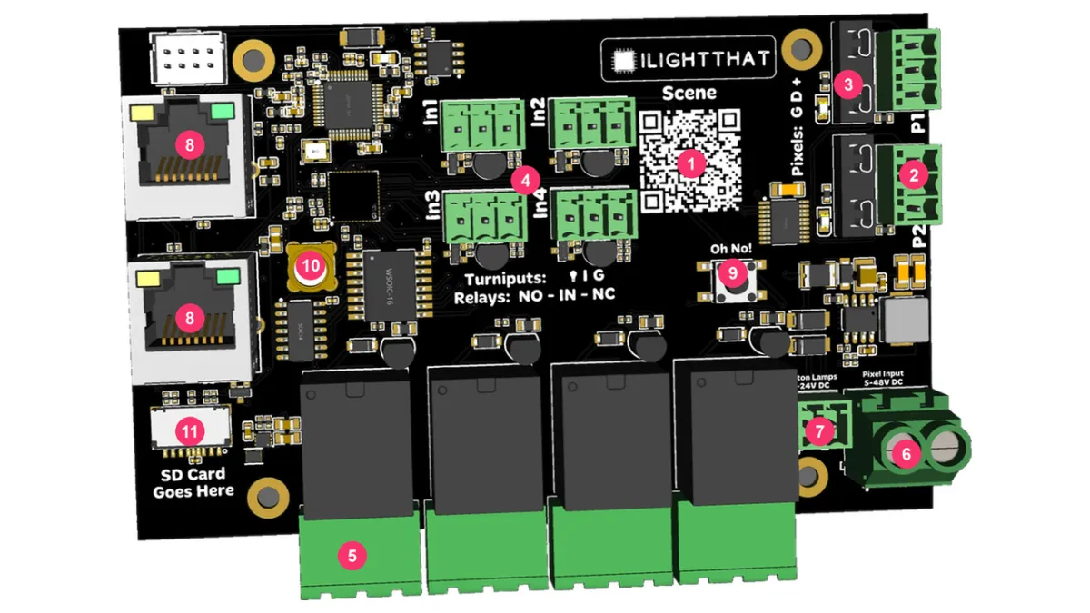

BaldrickScene board overview with numbered parts
  1. QR Code — An easy to scan QR code which will take you to these docs for easy troubleshooting.
  2. Pixel ports (P1 and P2) — 3 port Phoenix connectors, ordered G (Ground) D (Data) + (Positive / Voltage).
  3. Fuse holders — One for each pixel port, prefilled with 7.5A fuses and easy to get to when you need to change one.
  4. Turniput ports (In1 to In4) — Connect buttons and sensors to trigger effects and relays. Ordered lamp, I (Input), G (Ground).
  5. Relays 1 to 4 — Up to 8A and 300V (AC/DC), with NO - IN - NC terminals. See Connecting Relays.
  6. Pixel Input — 5v - 48v DC, steps down to power the components and powers your pixels.
  7. Button Lamps input — 5v - 24v DC, powers the lamp terminal on each Turniput port.
  8. Ethernet ports — Two 100Mb ports joined by a built-in switch. Plug one into your show network and use the other to daisy-chain to your next board.
  9. Oh No! button — Did you break our board? Press and hold this for 10 seconds on boot to reset to factory settings.
  10. WiFi antenna connector — Screw on an external WiFi antenna for CunningFX, Busk Board and board control over WiFi.
  11. SD card slot — For future expansion. Playing fseq files from the card should arrive in the next version of the firmware.
The BaldrickScene has the same medium footprint as the Baldrick8, so you can reuse your Baldrick8 bases and mounts. DO NOT DRILL out these holes to make them fit the screws you’ve got already, doing this will void any warranty.

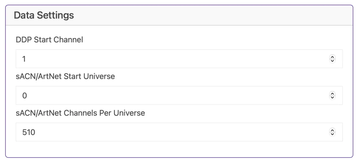

::: figure BaldrickSwitchy Web Interface Data Settings
