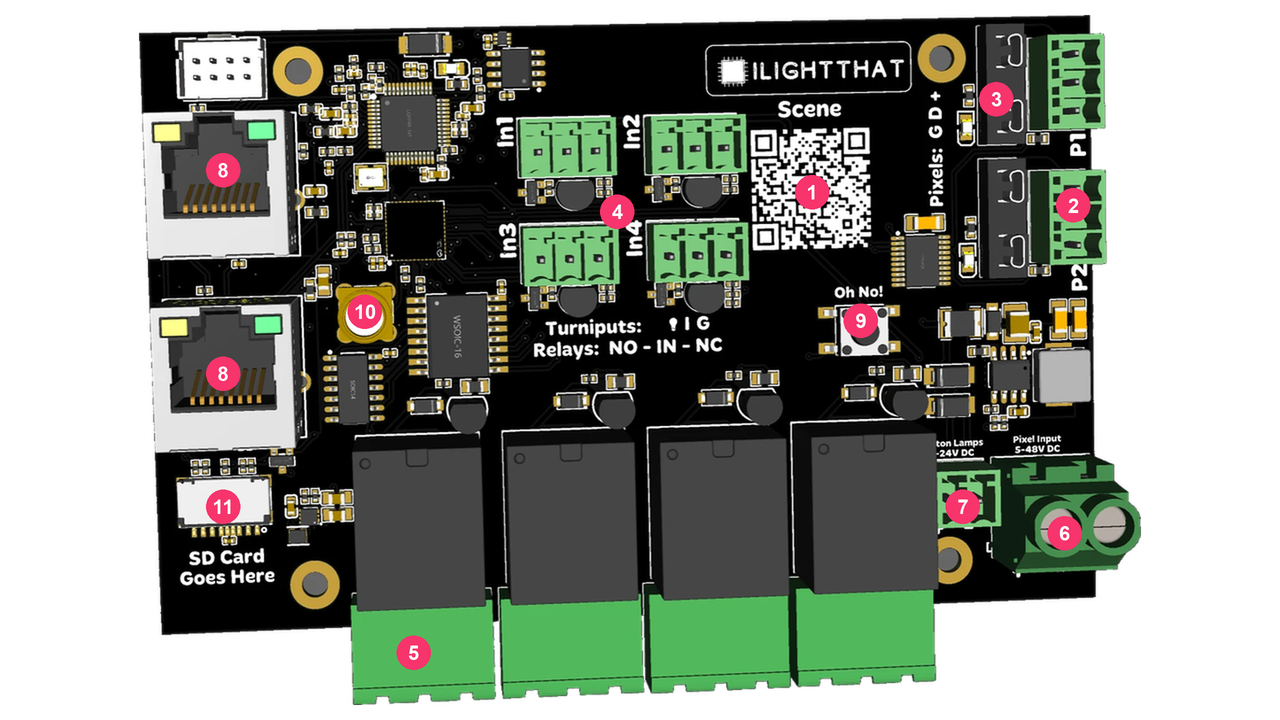

BaldrickScene board overview with numbered parts
  1. QR Code — An easy to scan QR code which will take you to these docs for easy troubleshooting.
  2. Pixel ports (P1 and P2) — 3 port Phoenix connectors, ordered G (Ground) D (Data) + (Positive / Voltage).
  3. Fuse holders — One for each pixel port, prefilled with 7.5A fuses and easy to get to when you need to change one.
  4. Turniput ports (In1 to In4) — Connect buttons and sensors to trigger effects and relays. Ordered lamp, I (Input), G (Ground).
  5. Relays 1 to 4 — Up to 8A and 300V (AC/DC), with NO - IN - NC terminals. See Connecting Relays.
  6. Pixel Input — 5v - 48v DC, steps down to power the components and powers your pixels.
  7. Button Lamps input — 5v - 24v DC, powers the lamp terminal on each Turniput port.
  8. Ethernet ports — Two 100Mb ports joined by a built-in switch. Plug one into your show network and use the other to daisy-chain to your next board.
  9. Oh No! button — Did you break our board? Press and hold this for 5 seconds on boot to reset to factory settings.
  10. WiFi antenna connector — Screw on an external WiFi antenna for CunningFX, Busk Board and board control over WiFi.
  11. SD card slot — For future expansion. Playing fseq files from the card should arrive in the next version of the firmware.
