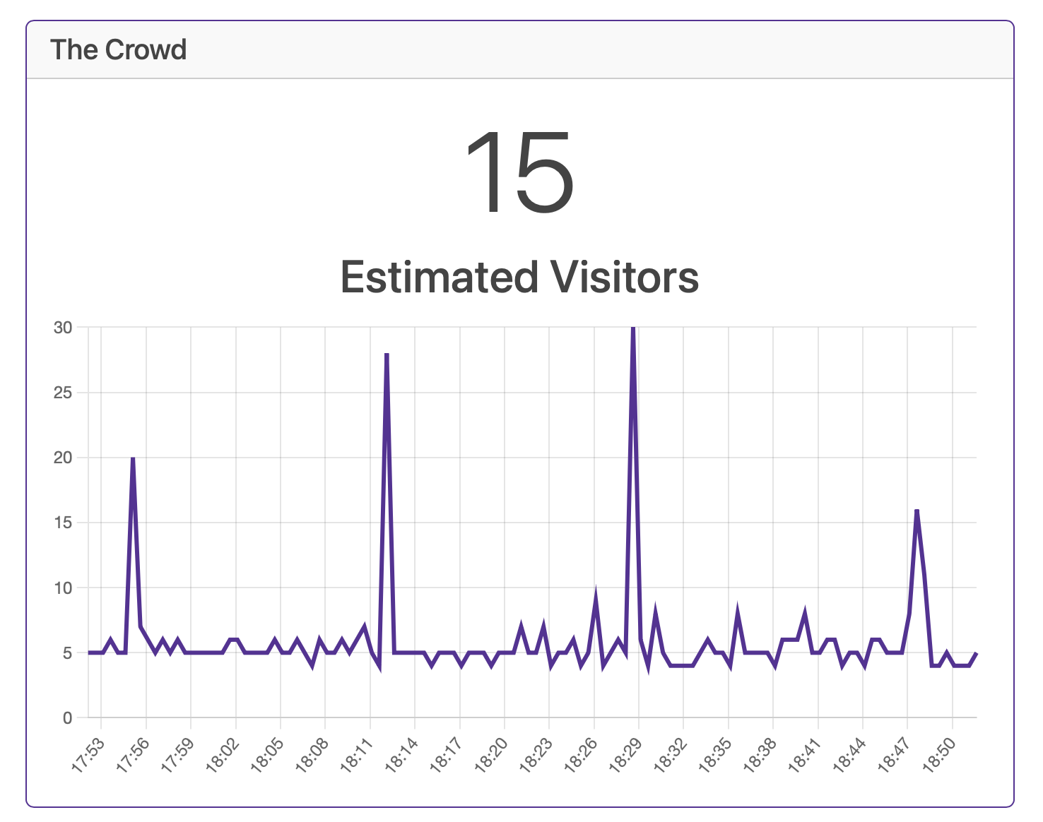

Crowd Monitoring
Crowd Detection
BaldrickCrowd Web Interface Crowd
Now we get to the good stuff. Every 30 seconds we will poll the universe (or at least as far as the antenna will detect).

Permanent Device Offset
At this current state of development and to comply with all data protection and GDPR laws, Signals gives you a static number of the devices detected. In many cases there will be devices detected which are present all the time (such as your phone). You can offset this by putting a number in this box (the number will never go below zero!).
Crowd Multiplier
Depending on your audience type, you might find that your audience isn't quite representative of the number of mobile devices detected (if you have a lot of young children visiting with parents you might find it vastly under counts). You can offset this by putting a multiplier in this box (the base number minus the offset will be multiplied by this amount).
