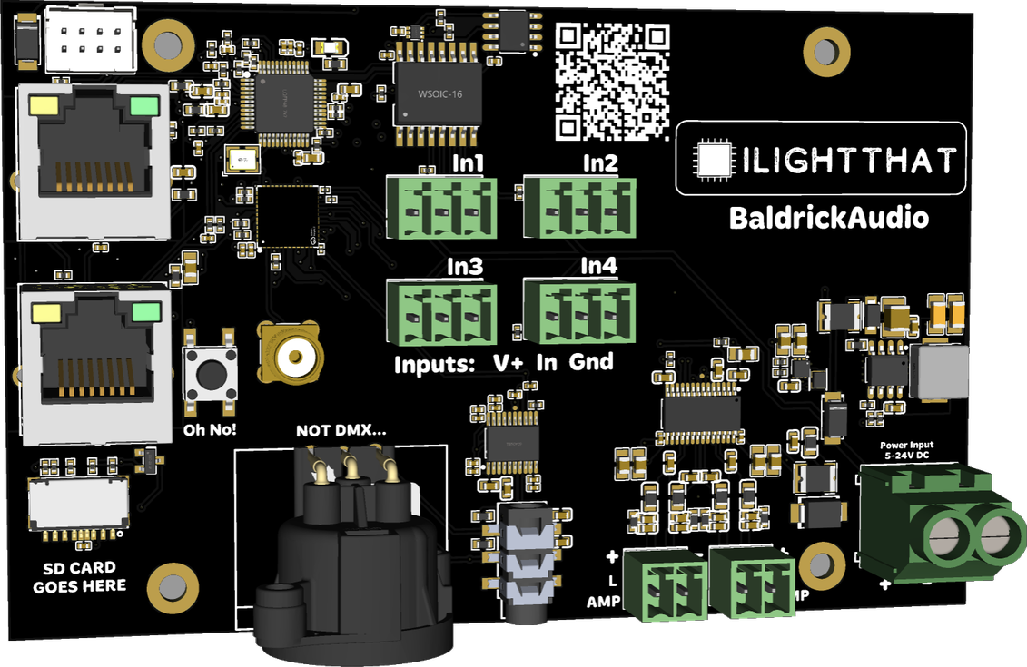

The BaldrickAudio is a simple board for anyone who wants an action to play a sound. Put some sounds on an SD card, hook up a motion sensor, and when someone walks past they're scared to death by the shriek of a little girl ghost. One trigger wasn't enough, so we added four, plus background audio (which is more complicated than you'd think!). With Busk Board and The Turnip Network you can trigger sounds remotely from your phone or other Baldrick Boards.
4-trigger sound player
BaldrickAudio controller board
Tech Specs
Technical specifications.
Inputs4 x V+ / In / Gnd for buttons or sensors
AmplifierBuilt-in 25W, 2 x 2-pin Phoenix speaker connectors (L and R)
Line outPre-amp on 3-pin XLR and 3.5mm jack
Audio files44.1kHz 16-bit stereo .wav
StorageSD card, FAT32, tested up to 32GB
Ethernet2 x 100Mb ports with onboard switch for daisy-chaining
WiFiOnboard with external antenna connector
Power input5–24V DC
MountingMedium footprint, fits Baldrick8 bases
