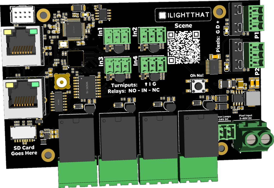

The BaldrickScene is the ultimate board for Halloween, interactive shows and immersive escape rooms, with 4 relays, 4 Turniputs and 2 pixel outputs. Trigger a jumpscare, light up a pixel sign or turn on that bubble machine that doesn't have DMX. With the Baldrick firmware at its core you get CunningFX, The Turnip Network and the built-in Busk Board.
Relays, inputs & pixels
BaldrickScene controller board
Tech Specs
Technical specifications.
Relays4 x up to 8A and 300V (AC/DC), NO / IN / NC contacts
Inputs4 Turniput ports
Pixel outputs2 smart ports
Channels per port2250 (750 RGB pixels at 40fps)
Ethernet2 x 100Mb ports with onboard switch for daisy-chaining
WiFiOnboard with external antenna connector
Power input5–48V DC pixel input, plus 5–24V DC for button lamps
StorageSD card slot (fseq playback planned for the next firmware)
ProtocolsDDP, Art-Net, E1.31, sACN
MountingMedium footprint, fits Baldrick8 bases
IntegrationFull xLights support
